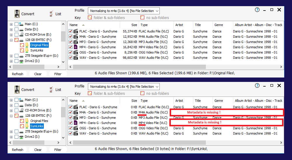

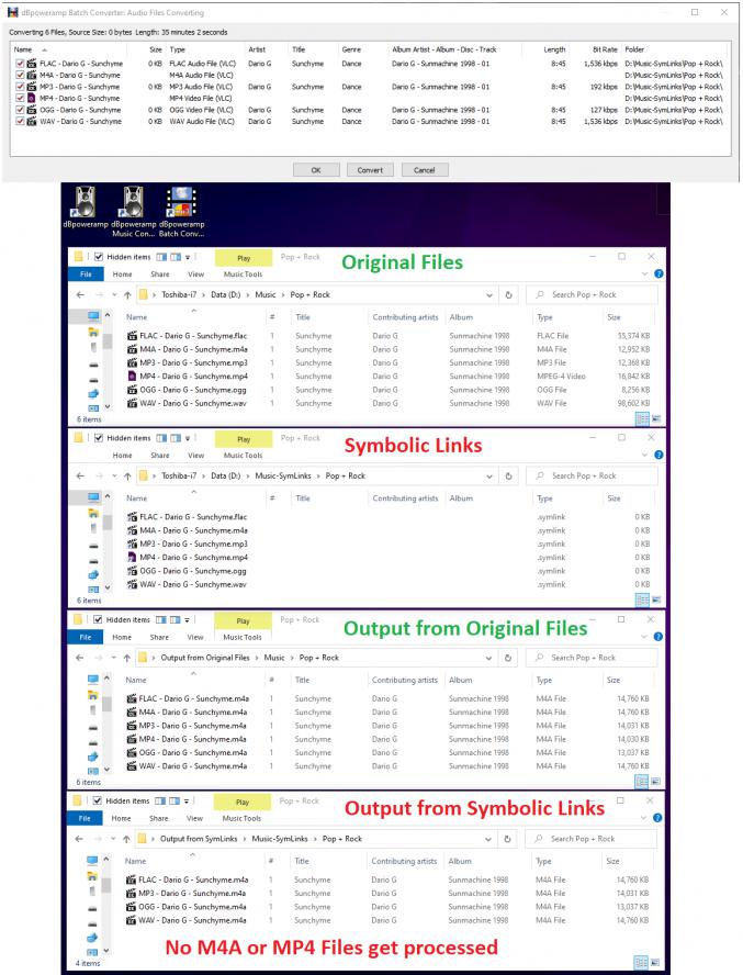

    When processing original files (not SymLinked ones), I can successfully batch convert all the file types I require, such as m4a, mp3, ogg, flac, wav and even most mp4 music videos. This allows me to conveniently use these converted files with my SONOS sound system, without any other file playback issues.
    However, if I try to batch convert the same SymLinked files, the Batch Converter seems to just bypass the m4a and mp4 files, with no error messages given. It appears that the metadata is not getting through to the Batch Converter for these file-types only, whereas all the other file-types appear, (with their corresponding metadata) and convert normally. What is so special about m4a files and mp4 files (that also usually contain aac encoded audio)?
    Note: I can successfully process these files with the standard dBpoweramp Music Converter (R17 reference). Unfortunately it is only the Batch Converter that just doesn't process the m4a or mp4 SymLinked files.
    If you look at my attached image, you'll see that the files listed for conversion (at top of image) don't have any metadata associated with them (even though that metadata is in those files). This metadata info only appears when I batch convert the original files rather than the identical Symbolic-Linked ones.

      This image hopefully might make things clearer:
      The "SymLinks" folder contains Symbolic Links to the same named files in the "Original Files" Folder.
      Note that there is no metadata appearing for the m4a or mp4 files from the "SymLinks" folder, however all other file-types are ok. That's really the crux of my problem... why do all the other files-types have no problems showing their metadata when SymLinked, yet m4a and mp4 files don't? It's a puzzle to me.

        The "SymLinks" folder contains Symbolic Links to the same named files in the "Original Files" folder.
        Note that there is no metadata appearing for the m4a or mp4 files from the "SymLinks" folder, however all other file-types are ok. That's really the crux of my problem... why do all the other file-types have no problems showing their metadata when SymLinked, yet m4a and mp4 files won't show? It's a puzzle to me.

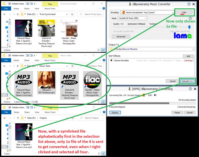

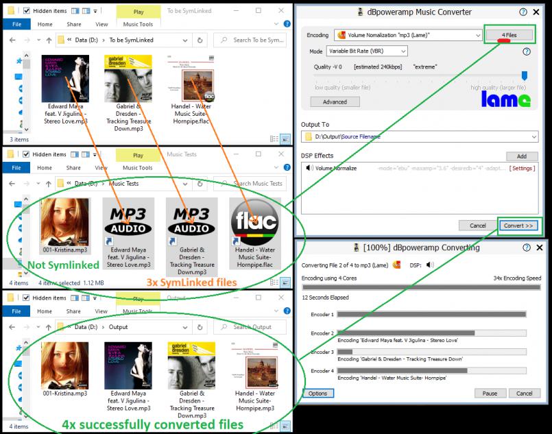

                    Using the standard Music Converter, and not the Batch Converter, if I select a mixture of symlinked files, together with at least one non-symlinked file, everything works well and the Music Converter happily converts all files to MP3 as desired.
                    However, if I don't include at least 1 non-symlinked file (or the non-symlinked files alphabetically don't come first in the list), then Music Converter (and Video Converter also, I might add) only seem to find [SIZE=3]1[/SIZE] file for conversion. ie. Next to the Encoder choice drop-down box, it will always only show one file to process, and that is all the number of files that it will in fact convert.
Name:	SymLinked Example 1.jpg
                    ... and here's an image of what happens (all things otherwise remaining the same) if I "don't" have the non-symlinked files positioned first.
Name:	SymLinked Example 2.jpg
                    So, there is something strange in how it sees symlinked files. I really hope you can sort this issue out, because I really want to keep using SymLinked files. It all works so well otherwise, for how I'm organizing everything.
