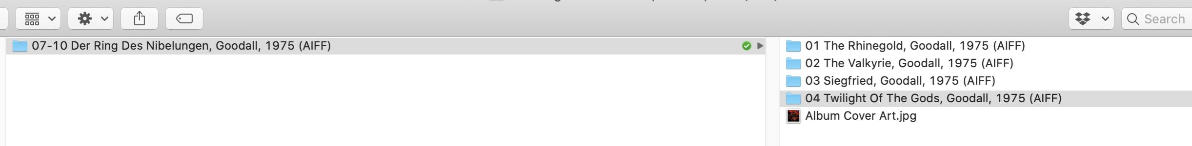

    In this particular instance, I have a complete Wagner Ring Cycle in 4 separate folders, all within a main folder:
Name:	Screenshot 2020-01-01 at 13.43.41.jpg
    When I select the main folder in "batch convert" & convert into "existing folders", it usually just does it.

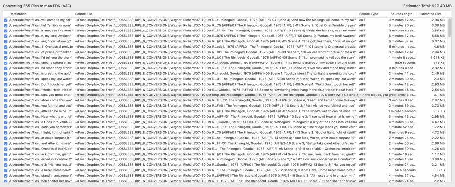

    But, occasionally, I get a window like this:
Name:	Screenshot 2020-01-01 at 13.36.47.jpg
    In the past, when I've seen this window, I have gone back to the finder & made a copy of the whole set of folders, just in case something gets screwed up, then done "existing folders" in batch convert again & it never comes up with this window a second time, even though nothing has changed.
    So...
    What's it for? What's it telling me? Am I okay to just click "okay"?

                  • 1618
                  Re: Why am I seeing this window..?
                  When selecting destination format & folder, there is a "Converting N files" button in the top right corner, which opens a window showing the files selected for conversion with their expected output per current settings, with expected output file sizes etc.
                  You must be clicking that instead of "Convert >" at the bottom. It has nothing to do with destination files already existing.
                  I'll change it to be more obvious and address readability issues.
                      Well, I didn't have the "issue" this time, so that must've been it. Thanks for the patience & perseverence, everyone.
