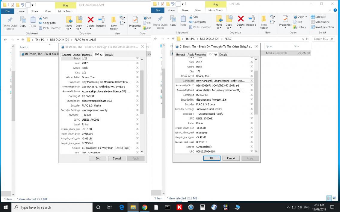

          In the attachment below for the same track on the same album the FLAC done from CD is on the right and the FLAC done from LAME is on the left.
          The Source field seems to tell the story.
          FLAC from LAME - Source CD (Lossless) >> Very High (Lossy) [mp3]
          FLAC from CD - CD (Lossless)
          Is this the same story for going from say FLAC Lossless (level 5) and trying to convert to FLAC uncompressed using dbP converter?
          (Maybe, as an aside, a way of checking if you purchase what you think is a "FLAC" copy online to make sure that you are getting what you paid for perhaps...)
