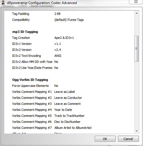

      Here's the advanced codec configuration setting - mp3, ID3v2 version set to 2.4:
Name:	Advanced Codec Configuration.JPG

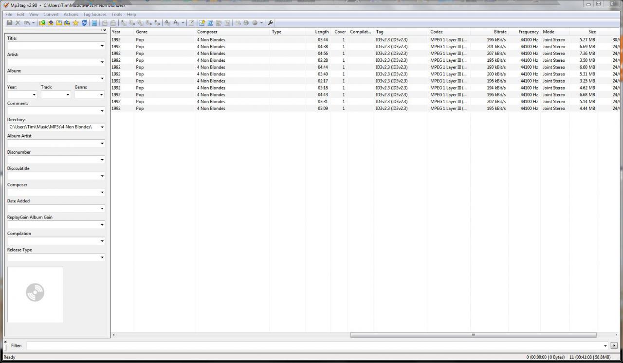

      and here's what mp3tag says after running ID Tag Update on the album - still at v2.3:
Name:	mp3tag after running batch convert.jpg
        [ATTACH=CONFIG]2210[/ATTACH]
        The mp3 ID Tagging >> Tag Creation option is wrong, as you have not selected ID3v2, rather APE2 & ID3v1.
          OK, selected ID3v2 in that option as you suggest. Made no difference I'm afraid. Still won't convert from ID3v2.3 to ID3v2.4. Seems to think as it's already at ID3v2.x it needs do nothing?
