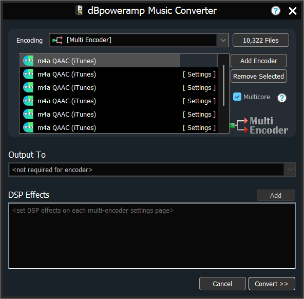

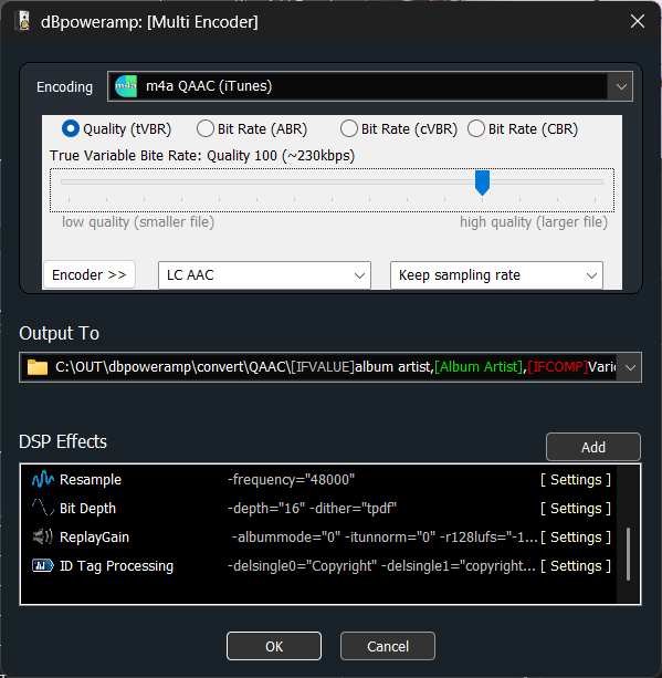

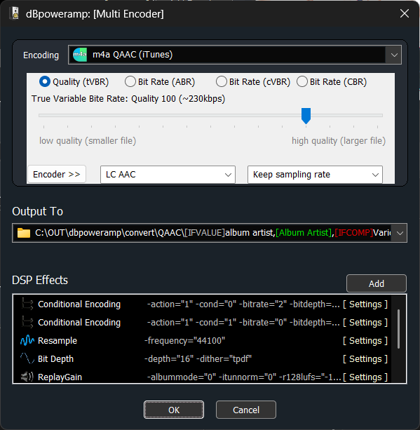

I have a mixed collection like many. However, for portable I go to the Apple encoders ALAC for iPod and Apple iTunes AAC for Portable/Phone, etc. Both of these really need to go down to 16bit 48/44.1khz from multiple high res sources.

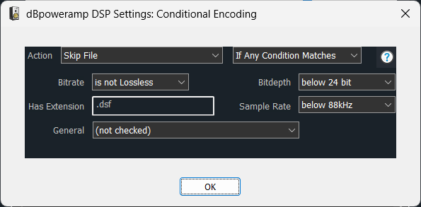

I was wondering if there is (or I guess could be) a way to automate this since I have a mix of 24bit 44.1/48/88.2/96/192
Like, look at the source and choose to resample or not and then choose the correct value to resample to.
With the recent updates to the software ive found myself reprocessing things. I have the system horsepower. It actually takes more time to pick out separate the sources before batch conversion.
DSD is easy enough, though I do have to remember to change it in the main settings before the conversion as usually when not doing this I would want 24/88.2 not 16/44.1 I'd want here.
