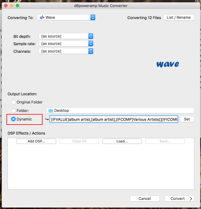

                • 1612
                Re: MAC version strings not working
                Sorry, cannot reproduce this issue, folders do get created here.
                Please note that folders get created only if you've chosen "dynamic" output location, not one of the other options.
