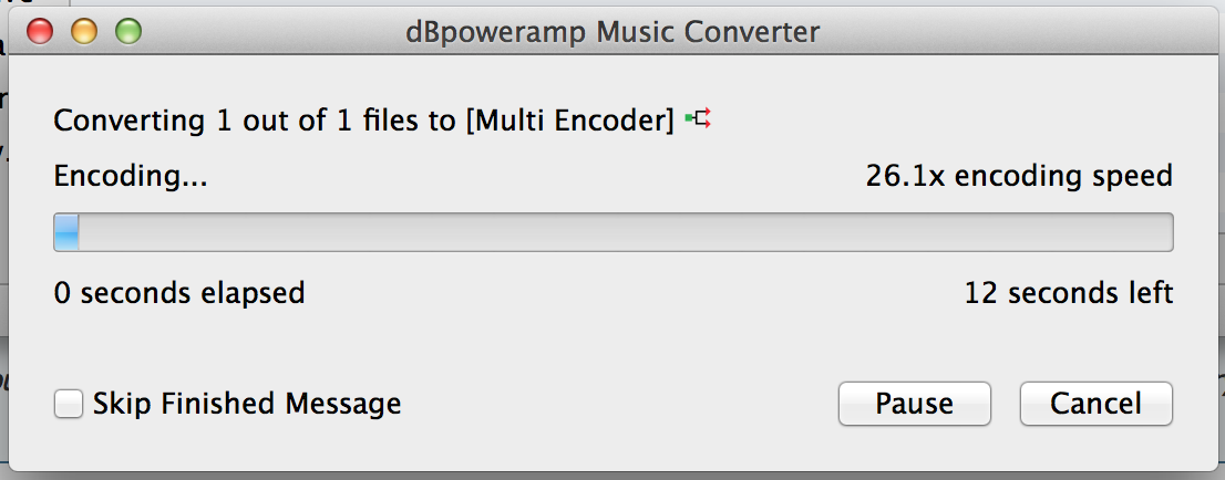

      When using Test Conversion in multi-encoder, it stalls on this screen:
Name:	Screen Shot 2015-11-25 at 09.47.10.png
      I am using OS X 10.9.5 Mavericks, with dBpoweramp 15.3.
      Thanks!

          Re: 24-bit Conversion Problem
          To clarify, you only had 1 encoder listed within Multi-Encoder, that was Test Conversion?
