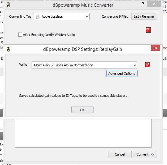

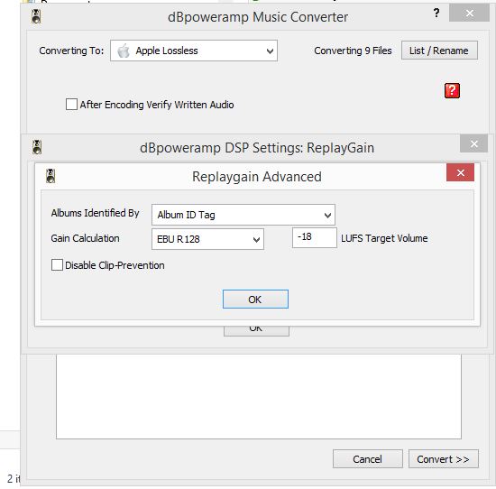

                          Re: RG codec not writing Album Gain tag, "All Files in Same Folder"
                          This *should* work automatically for you. Note that itunes doesn't use RG values at all. It uses the itunes normalization values (that are also written by the dbpa RB DSP and then used by iTunes). You've got both these settings as in the attached pictures.
