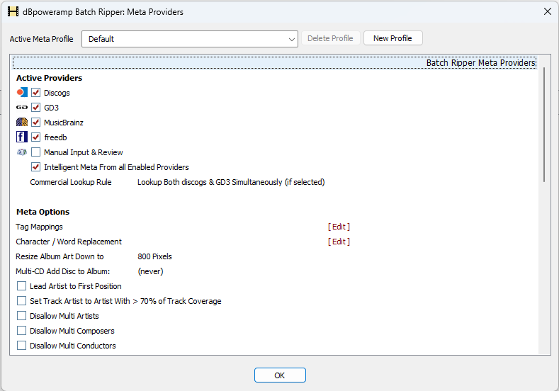

          Hey again Spoon,
          I just tried out some different metadata configurations.
          The CD I'm testing is brand new, and I have been trying each metadata provider individually to see who provided what in CDRipper.
          1. Freedb (freedb.dbpoweramp.com) provided nothing.
          - I suppose it's not in the database yet.
          2. CD-UPC provided UPC.
          3. CD-ISRC provided ISRC.
          4. CD-Text provided nothing.
          5. GD3 provided everything except ISRC and UPC.
          6. Musicbrainz provided nothing.
          7. AMG provided nothing.
          It seems that BatchRipper is not reading the local data embedded on the CD.
          Is there a something I'm missing?
          The most important data to me is the UPC and ISRC.
            • 1914
            There is an option to read the metadata from "CD Text" in the menu "Retrieve Metadata From". At least in V17.7.
