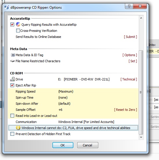

        Try CD Ripper >> Options
        and set communication to Windows Built in.
        • WRTImusic
          • 8
          Re: Ripping Errors / Slow Rip
          Is this the setting you are referring? There is no checkbox.
            • 46099
            Yes this is the option.
