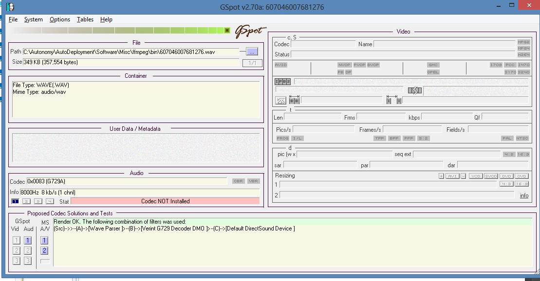

    - Upon using gSpot to analyse the codec, it tells me it is a Directshow Codec
    - You can only play the files using a directshow compatible player like Windows Media Player
    - I cant use VLC :( nor can I use FFMPEG :(

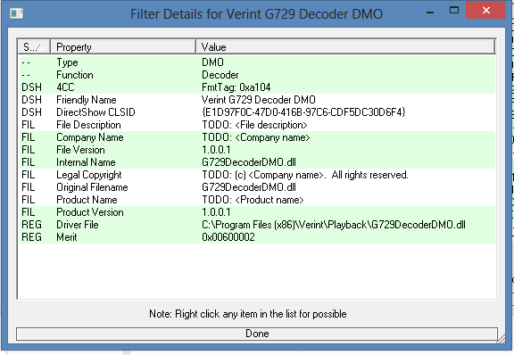

      These are the gSpot codec details, which led me to assume it was a directshow DMO codec.

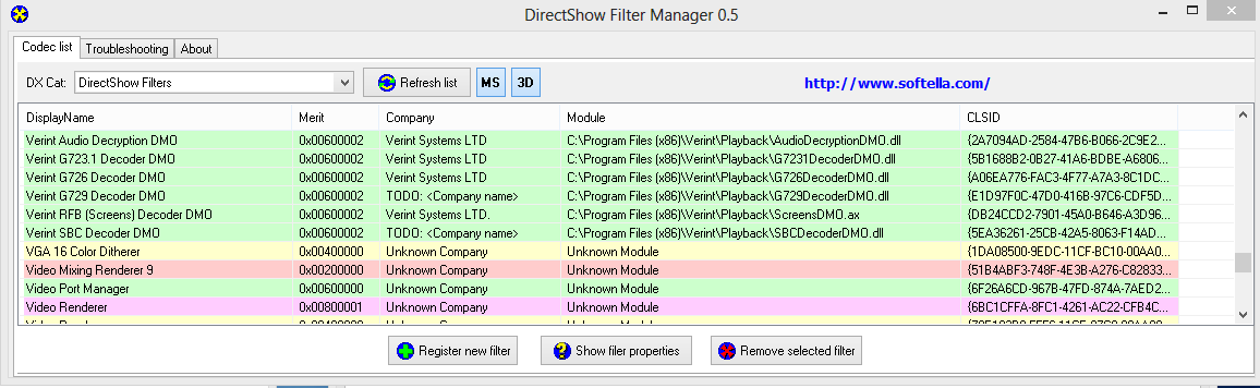

        Ah I found to a directshow filter manager:
        DirectShow Filter Manager - utility to help list, sort, find, add or remove DirectShow filters. Tool also can be useful for everyone when installing someting like Nimo codec pack.
        and Click image for larger version
        So it looks like its listed... but i dont know why dbPowerAmp's plugin can't utilise it. :(
