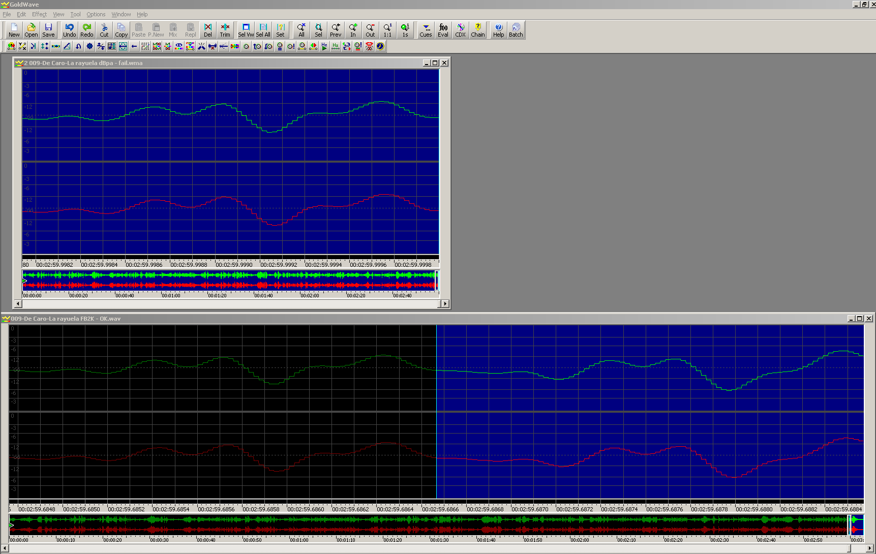

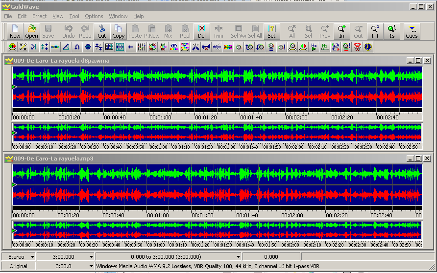

    and (alarmingly) the output WMA file is created with six seconds of audio missing from the end: Click image for larger version

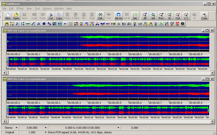

    Other programs e.g. MediaMonkey (but, FTR, gives differing audio e.g. see this shift Click image for larger version
ID:	296834) doe not show this failure on this mp3 file.

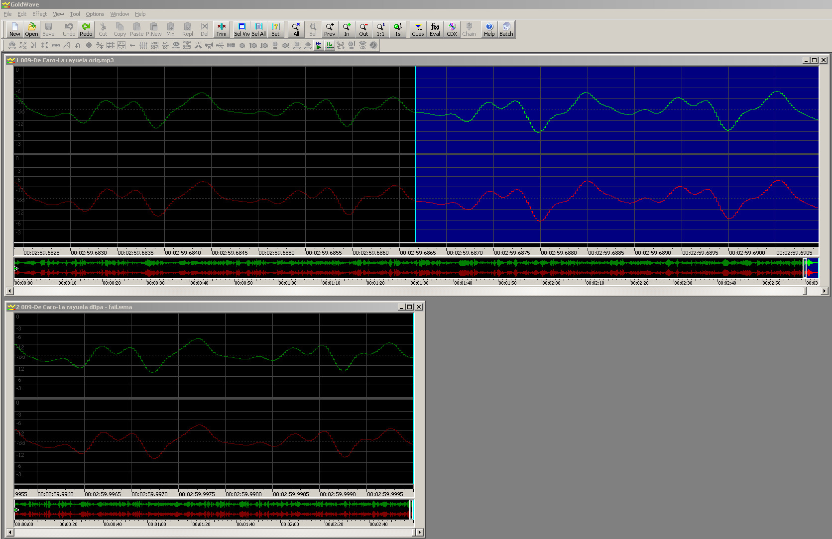

          Re: R15 Batch Converter - mp3 decode fail
          It does not show the failure i.e. it converts the file fine - no error, no truncation.
          Same with GoldWave, JR Media Center, VLC Media Player. dbPoweramp is the only program I can find that fails.
          Plus I notice at the dbPoweramp cut-off point in the original file, there is no visible Click image for larger version
ID:	292677 or audible sign of any error in the waveform.
          It really looks to me as if dBpoweramp is faulty in this case.
