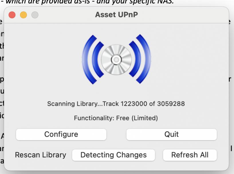

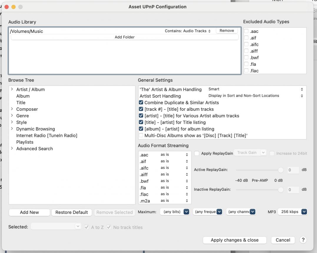

      I think the basic problem here is that I don't really understand the principles of what I am doing. I previously had a ZoneRipper acting as my NAS and running Asset effectively. I removed the ZoneRipper and added the Synology NAS, using your standard protocol with all the guidance on settings to install Asset on the Synology NAS. This resulted in a lot of duplication and corruptions. I have Asset installed on my iMac which is where I assume I edit the settings. I went there and changed the library location to the location on the Synology NAS, which Finder sees on my network (all hard wired incidentally)Click image for larger version

ID:	294735. I think that Asset has either fully or partially scanned this library according to the Control Panel (attachment shown).

        • 46231
        Re: Problems accessing Asset on Synology DSM7
        Your screenshots are of asset running on the Mac, you should remove Asset on the MAC as it just confusing the issue. Then click on the configuration page on the synology (from the dashboard of the synology).

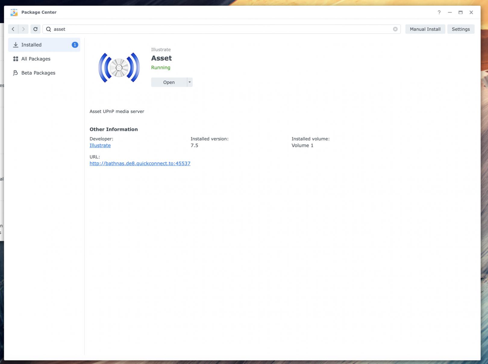

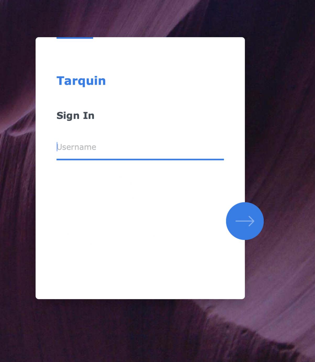

          I am now looking at the Synology via the web portal and when I try to configure which I assume I do by opening the Asset icon, it directs me to a login under the name of Tarquin. I have no login under this name. Where do I go from here.

                • 1656
                It appears that Synology is giving you a link using your internet (public) IP, instead of the local network area address. This will not work, Asset is not meant to be accessible from the internet.
                I just wrote a help article about this scenario:
                In some scenarios, most commonly with Synology, the NAS operating system isn't presenting the Asset configuration link properly and Asset configuration cannot be trivially accessed. Note that you can NOT access Asset UPnP configuration over the internet. Your machine accessing Asset configuration must be on the same local
