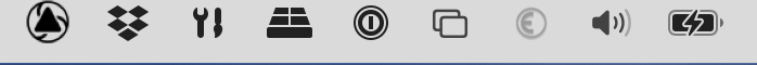

    It appears as a icon in the top right.

      Hello Spoon. it doesn't though. It used to appear there but it no longer does. I went back to my old hard drive and I can play songs from it. I have encrypted my newer drive and that may have been the reason why I wasn't able to play anything from it through the Asset UPnP (should have researched that first) but I still can't see that Asset UPnP is running anywhere although it clearly is.

              Hello PeterP. Sorry for the slow reply. I have been working away from home and system. Yes, thank you. I know about the icon in the menu bar and that it does keep a window open. But I am not seeing that icon in the menu bar.

                              Weirdest thing happened. Today, running 7.5 the asset icon appeared again and is functioning normally. I haven't updated my OS or the app to your new version. Did you see the issue on another computer? I will upgrade but I have no idea why it decided to work again.
