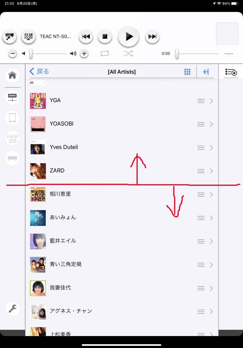

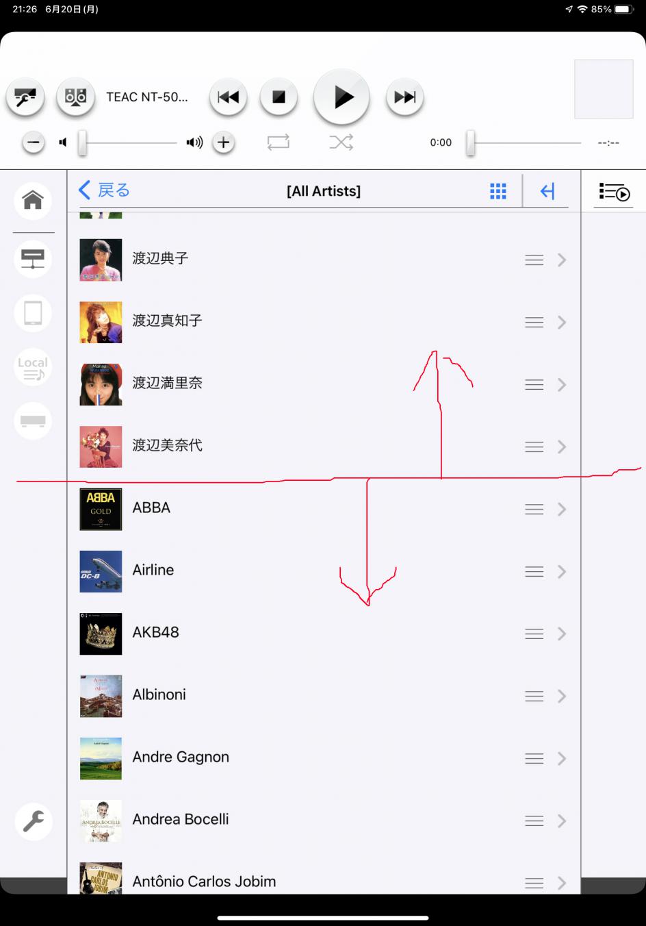

              hello. Thank you for your suggestion.
              I understand that Asset UPnP does not support Japanese.

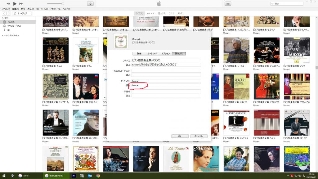

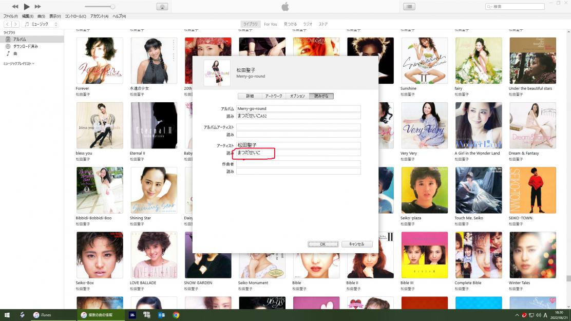

              I use ALAC files on iTunes and distribute them on QNAP. Until 7.3, Japanese artists lined up as expected without any problems. The order of the albums the other day was solved by fixing the tags that were slightly different from each other. The only difference from the previous one is that when All Artists was selected, Japanese artists were lined up next to ABC ..., but when set to 7.4, ABC ... followed by Japanese artists. to line up. I don't know why it changed from 7.4. Attach an image of the Technics Music App and iTunes on my iPad.Click image for larger version

              &*9312; Music App 7.3 ABC ... Japan
              &*9313; Music App 7.4 Japan ABC ...
              &*9314; A tag for arranging iTunes artists&*12288;Japan
              &*9315; Tag for arranging iTunes artists&*12288;ABC
              Again, I know that it doesn't support Japanese. I hope it can be solved.
