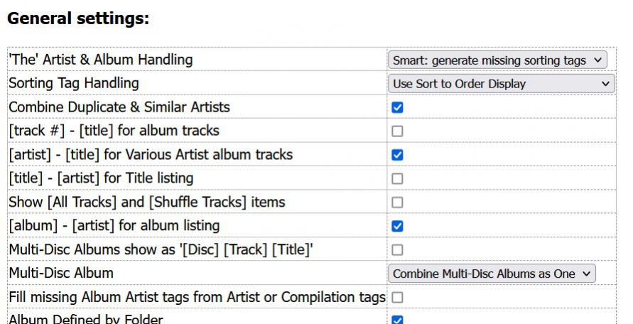

    Since I upgraded to Asset 7.4 on my QNAP NAS multi-disc albums are no longer showing as one album despite having the multi disc album option set to combine as one

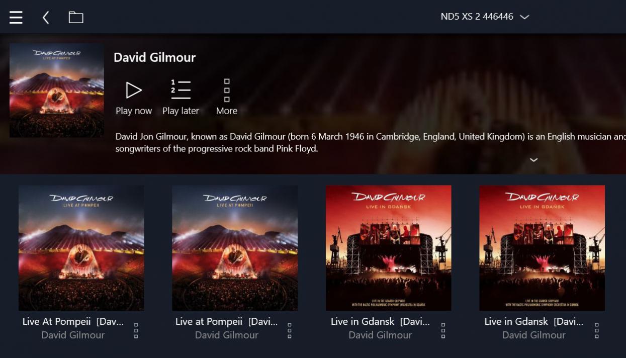

    For example these two David Gilmour Albums used to show up as one icon for each not two
    Is this a bug or am I missing something?

        ... looks like I spoke too soon.
        This behavior is a result of a new "Album Defined by Folder" option, which is on by default. It causes media in distinct folders to be treated as distinct albums regardless of tagging.
        Please turn it off and everything should work as expected.

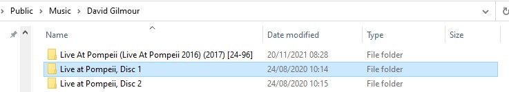

              I'd need to go to 7.4 again to be absolutely sure but off the top of my head the problematic ones are where there is a parent album folder with sub folders for Disc 1, Disc 2 under that, rather than "Album - Disc 1" and "Album - Disc 2" at the same level.
              I think this is also one that all got merged together in 7.4
Name:	Screenshot 2022-06-01 123040.jpeg
              The ones with a Disc1, Disc2 suffix are CD rips whereas the other is my hi-res version but both have the same album title tag. In 7.4 with the Album defined by folder off both versions get merged in to one album but 7.3 keeps the CD and hi-res versions separate with Album defined by folder set to on
