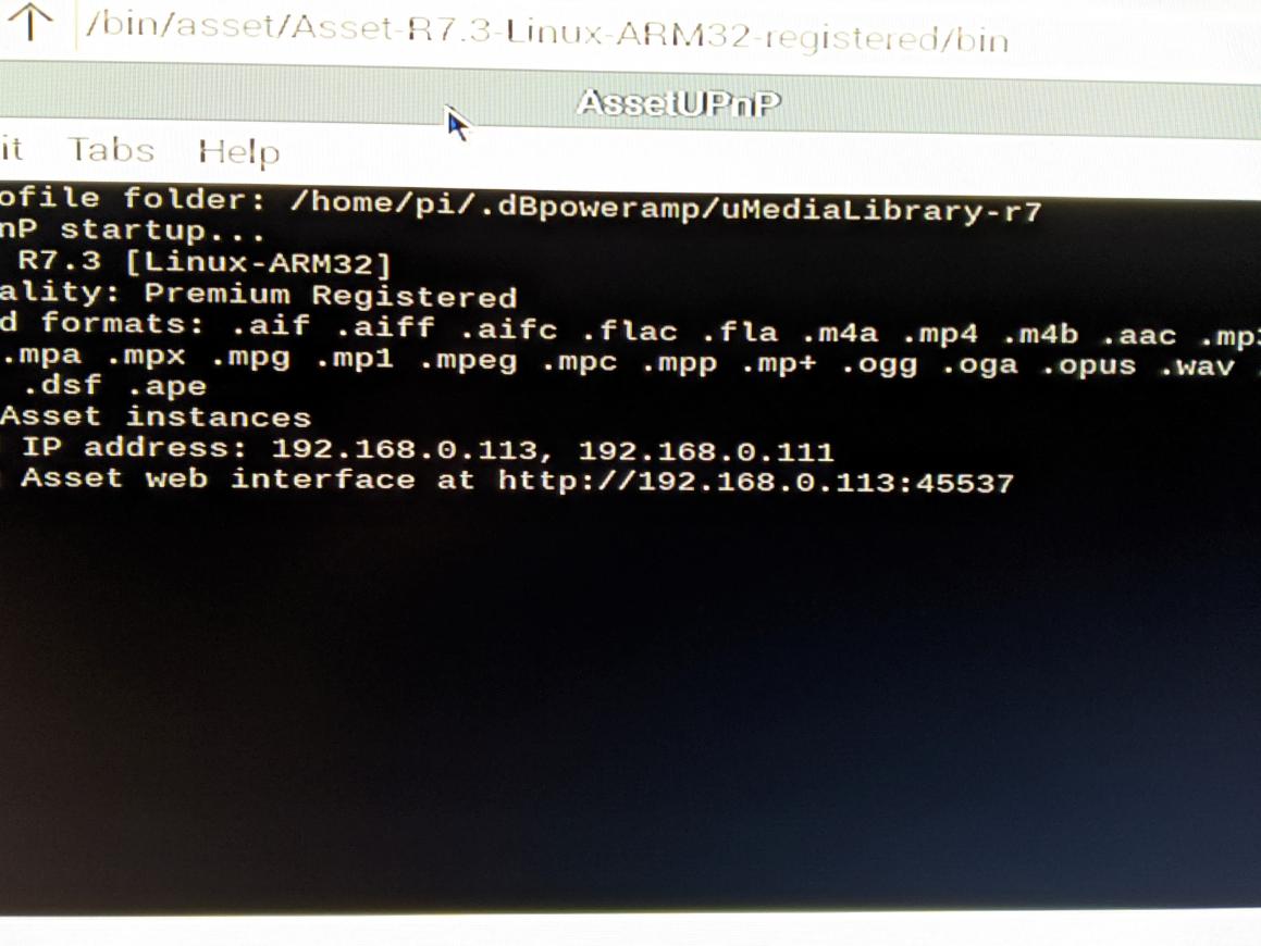

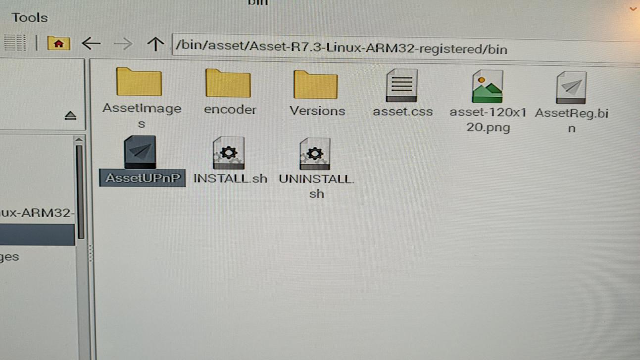

    Dear everyone
    I have managed to install Asset onto a Raspberry Pi 4 Version 7.3 mounted in an Argon M.2 case with a 1TB WD Red SATA SSD installed. I can get Asset to work by clicking on the Asset UPNP file in (see below) It can read my music folders stored in Pi/Media/SSD/Lost and Found.
    This brings up the following:

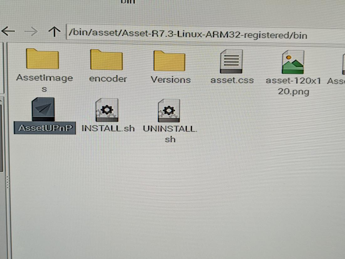

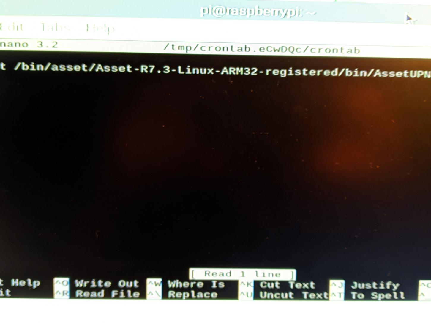

    I tried the setting that was suggested on this forum:
    As yet, I cannot get Asset to run on a reboot.

    Re: Getting Asset UPNP to reboot automatically on Raspberry Pi
    Check the line you have typed in to the contab, you can post the full line here?
    • Luvv1e123
      • Nov 2021
      • 9
      Thanks for gettng back to me. The line I have typed in the contab is @reboot /bin/asset/Asset-R7.3-Linux-ARM32-registered/bin/AssetUPNP.

          • 46231
          If you open a shell prompt and type:
          (I assume the . on the end is not present), does asset start?
          • Luvv1e123
            • Nov 2021
            • 9
            Sorry in the delay in getting back. I have just tried typing the line in the shell prompt and the bash response was 'no such file or directory'. If I go into the directory and click on the Asset UPNP file (in grey) I am given the box 'This is an executable file. Do you want to open it in terminal?' If I click yes, Asset opens. Hope that is of some use.
              • 46231
              It means '/bin/asset/Asset-R7.3-Linux-ARM32-registered/bin/AssetUPNP' is not correct, something might be missspelt, or a capital letter is missing, double check the string, until you can manually start it in the shell, you cannot hope to get the crontab working.
              The correct one is:
              /bin/asset/Asset-R7.3-Linux-ARM32-registered/bin/AssetUPnP
