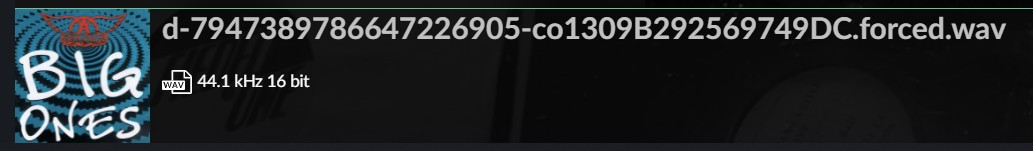

    2). Transcoding to wav24 does not work, only to wav - not biggy, but now that I tried it.

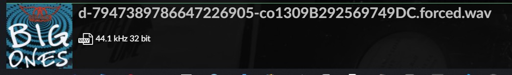

    3). Adding replay gain shows files as 32bit wav, really?

          Asset never serves 32 bit audio unless the source was 32 bit.
          24 bit transcoding does work, it has for the last 8 years, no complaints there. I would start simplifying your system, install foobar2000 with https://www.foobar2000.org/components/view/foo_upnp as a test player and control asset directly from it. You should find everything mentioned here works.

            Re. transcoding, 24bit showing as 32bit in Volumio Primo web interface, which is what I use when I work. Hi-Fi Cast shows it as 24bit. Same goes for 32bit. I believe you are correct, as the other devices report what you say. It is Volumio bug.
