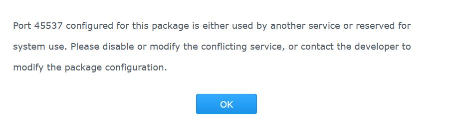

    Hi all,
    i am trying to install the Asset UPNP trial V7.2 on Synology DSM6 but got this error message
    My Synology DS220+ is clean and only has basic packages, Minimserver and PubbleUpNP Server installed on.
    Could someone give me a hint how to solve it.
    Many thanks!

    Weird, i can not found other service which uses port 45537 and a bit disappointed Asset UPNP that don't let install on other port:-(
    I never have such trouble with minimserver.

      Did you previously try to install Asset? we are not aware of anything using that port.

        @Spoon thank you for replies. No I installed Asset first time at all but now I guess the reason may be that I have done a memery test of my DS220+ with Synology Assistant before. After rebooting the Synology I was able to install Asset.:-)
