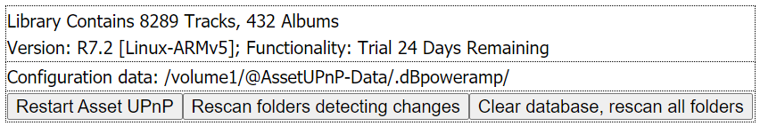

          Re: "The" Artist & Album Handling
          I've installed the trial version of R7.2 and I'm using the Synology DSM6 version -

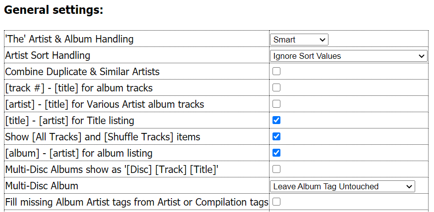

          My initial impressions of using Asset are extremely positive, with the speed of browsing being infinitely better than when using Synology's Media Server. However I seem to be having an issue with the function of 'The' handling option, when switched to 'Smart' -

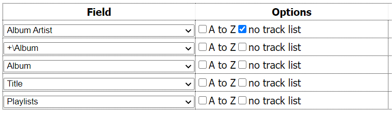

          Unfortunately, the Album Artist view fails to physically display relevant artists (such as The Beatles) alphabetically under anything but 'T'. The same goes for the Album view, so "The Best of Ella Fitzgerald" isn't displayed under 'B'. Am I missing something somewhere, as I've tried to ensure my Browse Tree is quite simple -

                            Thanks for the data.
                            Please set &*8220;Artist Sort Handling&*8221; option in General Settings to something else than &*8220;Ignore Sort Values&*8221;; this should cause Asset to show your artists and albums in correct order.
                            We&*8217;re revising the naming of these options to make it more clear what they do - &*8220;Artist Sort Handling&*8221; actually affects listing of albums also.
