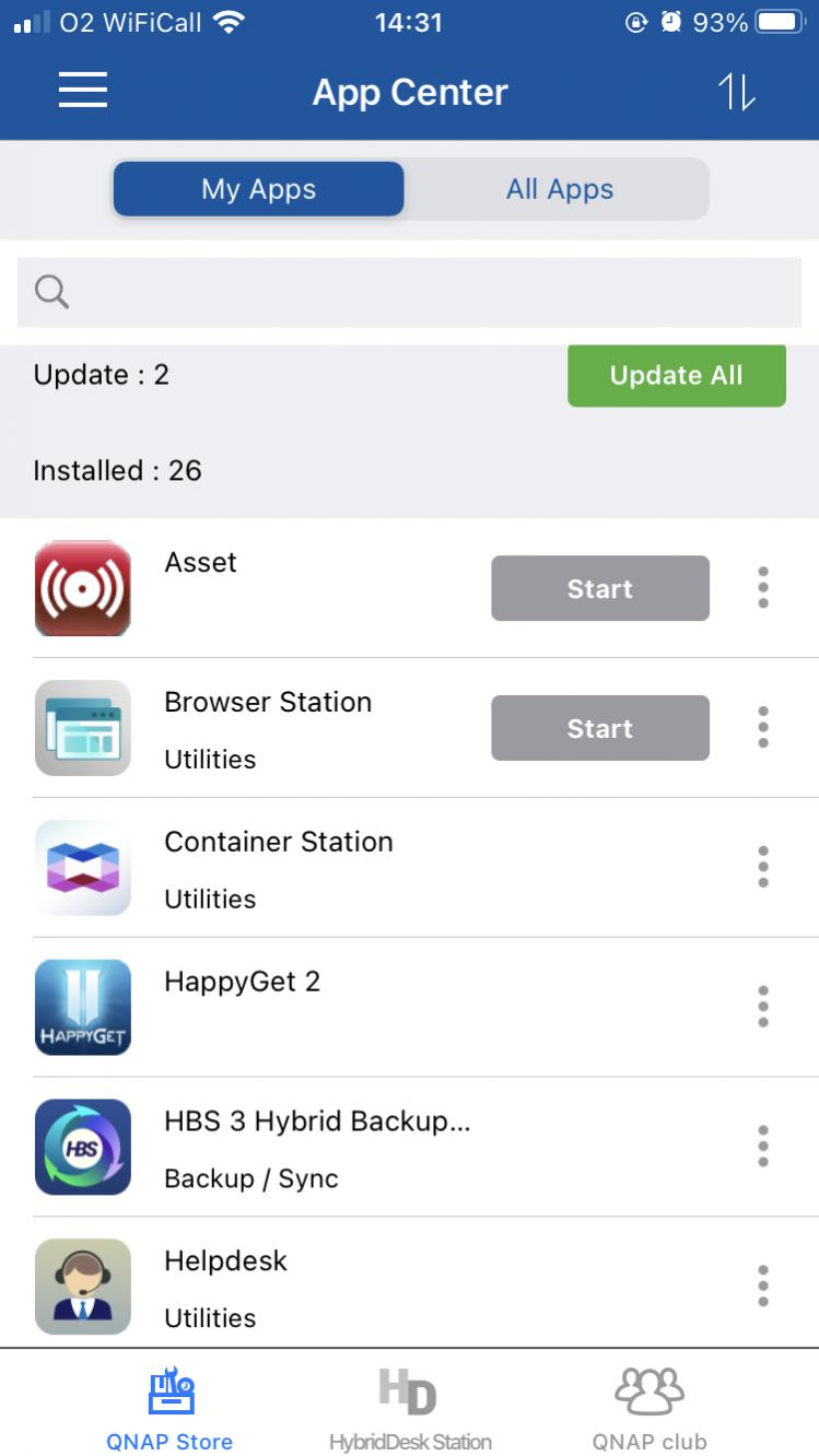

          Re: Qnap 4.5.1 No digital signature
          Originally posted by sjbabbey
          Hammerhead
          I haven't tried this yet as I don't want to "Stop" Asset and have to regress my firmware again but it may work for you.
          QNAP have an app called Qmanager which you can install on an ipad/android tablet or smartphone. Using Qmanager the left hand side menu has a link to your QNAP's App Centre. In mine the Asset icon is listed as installed and has 3 dots on the right hand side which opens a menu. In that menu I have the options to Stop the app, Remove the app or Cancel (Leave the menu). This is because my app is still active and I can access its config page from the front menu icon on my QNAP.
          Hopefully, if you open the Qmanager app on your device the Asset logo will appear and have the option to "Start" Asset.
          Please try this if you can and report back either way.
          Brilliant - this worked for me. I saw the attached on my iPhone and just pressed 'start'
          I know that QNAP want to be cautious about unsigned apps but I don't think that they should be blocking them! I've just seen the later reply on this as well.Click image for larger version
