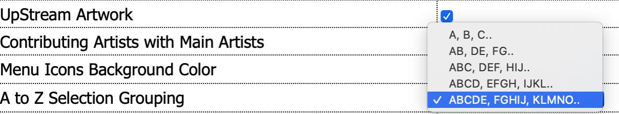

          Is there any way to NOT HAVE in the browsing the FOLDERS for each alphabetic Letter ( A- B - C -D etc...)?
            • 46231
            Re: Synology Set up + Linn Music App
            If you edit the browse tree and turn off the A=Z option.
            • Orpheo
              • Apr 2020
              • 5
              Seems that there's not ON/OFF option
              just different way to see the folders.
              see attachment
                • 46231
                If is not that option, you switch off the a-z for the specific tree item which is showing it.
                • Orpheo
                  • Apr 2020
                  • 5
