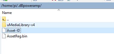

          What is the name of the database file This is all that is in the directory you indicated. What permissions should this directory have?
          Yes I have to rescan after startup.

              First, there's no problem with access to Asset's configuration folder - or else all settings would be getting lost, which they are not.
              It seems that the network share is randomly inaccessible on startup - presented to Asset as an empty folder, hence disappearing library.
