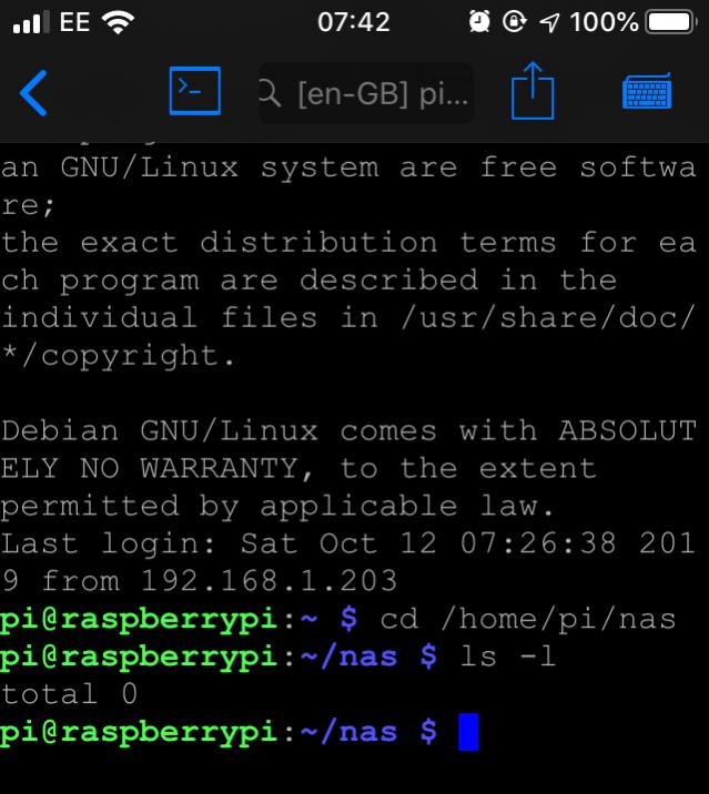

      If you open a command shell, can you navigate to this directory and ’see’ the contents of the volume on the NAS volume? - does this tell you anything:?

        This tell me anything?
          • 46231
          Re: Help setting up AssetUPnP on Raspberrypi
          It does not look mounted, ls -l would list all the folders on the nas.
          Does your nas not require a password? cifs is based on passwords unless the guest account is active.

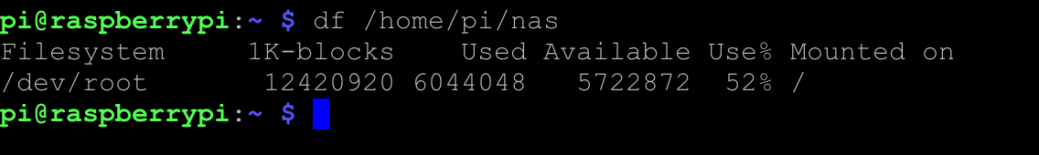

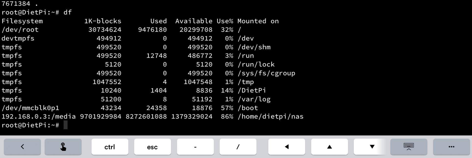

            No if you run a df or even a du command it should give you the usage of the mounted file store
            Where are you running a sudo mount -a command to actually execute on the contents of the fstab file?

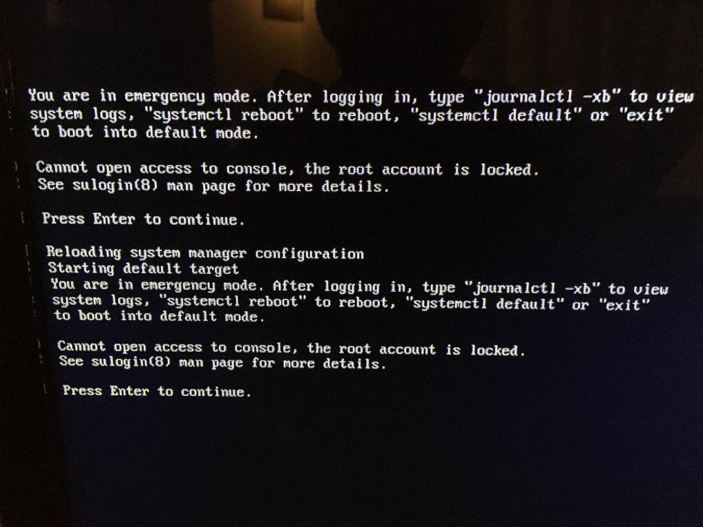

                    Oh dear, thought I was getting somewhere, and then on a reboot nothing happened, so I plugged the pi into the TV and it came up with this:
                    This likely to be something I’ve done, or a faulty pi?
                    • simes_pep
                      • Dec 2013
                      • 300
                      Sorry, thats a new one to me.
                      What OS are you running on the RPi?
