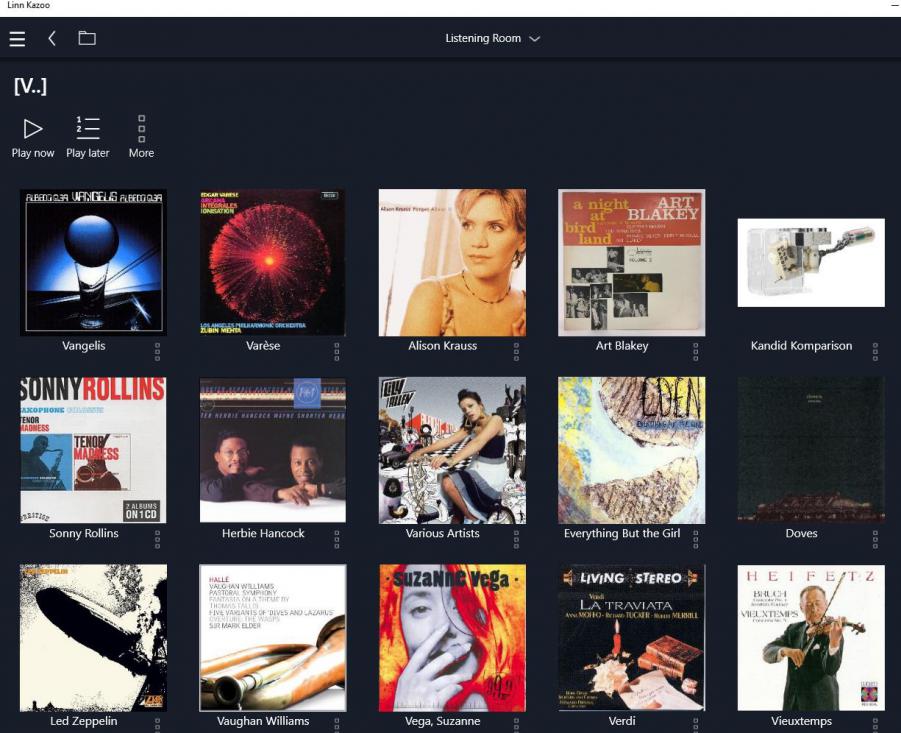

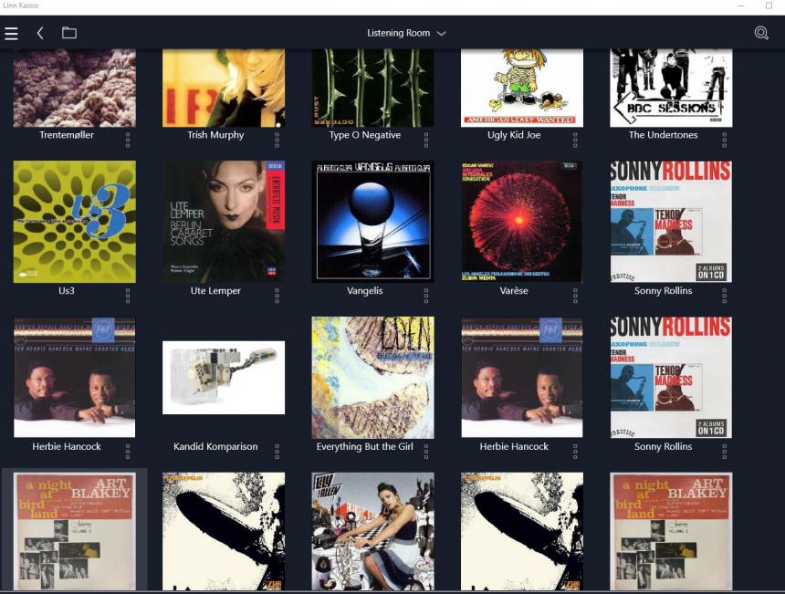

    If I then ask 6.x to 'Refresh All' several Album Artist are then once again in the wrong place, and in some cases duplicated.Click image for larger version
    The screenshot is of Linn Kazoo, but BubbleDS Next shows the same structure.
    I tried picking on Herbie Hancock and, using dBPoweramp, removing all the tags, converting to WAV, converting back to FLAC, and re-tagging, then performing a full refresh. The result was Herbie still under V. If I change the Album Artist tag to AAA, it then appears under A, as it should.

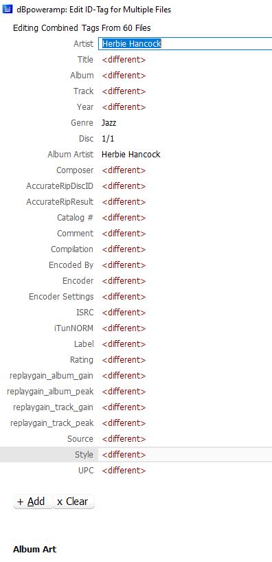

      Many thanks for the suggestion, but I don't typically use the sort tags (though I probably should now that more things support them).Click image for larger version
Name:	All Herbie Hancock.JPG
ID:	294096 That's all the files in the main Herbie Hancock folder as shown in the ID-Tag editor, so it's not those causing the issue if it is down to Album Artist sorting.

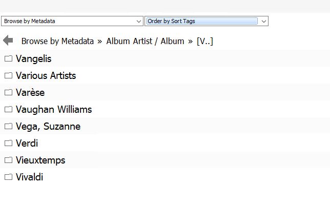

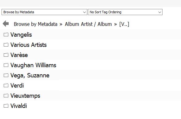

          OK - I already had a copy of Perfect Tunes installed (3.2), so I've let it update its cache and removed all Album Artist and Artist sort tags, not that, as mentioned above, there were many set. So, with no sort tags set anywhere in the library, I "Refreshed All".
          Now if I choose either of the options "Display in Sort and Non-Sort Locations" or "Use Sort to Order Display", the same Album Artists still turn up in the wrong place, so it seems not to be anything to do with the sort or Album Artist tags.
          Also, if I use Perfect Tunes to browse by metadata, either with sort Click image for larger version
Name:	Perfect Tunes With Sort Tag Ordering.JPG
ID:	294097, or without it Click image for larger version
Name:	Perfect Tunes No Sort Tag Ordering.JPG
ID:	294098, Perfect Tunes shows what I'd expect (and the same as 5.1 shows) under V, whereas Asset 6.2 is feeding Kazoo this: Click image for larger version
Name:	Incorrect Tree in 6.2 after Perfect Tunes tweaks - V.jpg

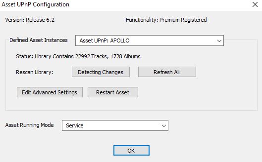

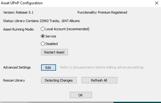

          If I uninstall 6.2, reinstall 5.1, and let it use the "Display in Sort and Non-Sort Locations", it works as expected. Also 5.1 arrives at a different album count to 6.2. 1847 Click image for larger version
Name:	Asset 5.1 Album Count.JPG
ID:	294100 for 5.1 vs 1728 Click image for larger version
Name:	Asset 6.2 Album Count.JPG
ID:	294101 for 6.2, but both count the same 22992 tracks.

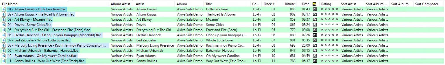

              The bad news: Asset 7 Beta 3 appears to behave like 6.x not like 5.x or Perfect Tunes.
              The good news is that I think the cause has become clearer. Some experimentation has identified an old compilation as a set of tracks which seem to upset the scanner. Click image for larger version
Name:	Tagging which seems to upset Asset.jpg
ID:	294102 For some reason, it seems to use the fact that identically titled (but differently Album Artist) tracks exist elsewhere in the library to pull the entire other Album Artist under V when Album Artist sort is set. So the Album Artist sort for these tracks somehow is sticking to other tracks and albums tagged with a different Album Artist. Presumably V because the sort is Various Artists
