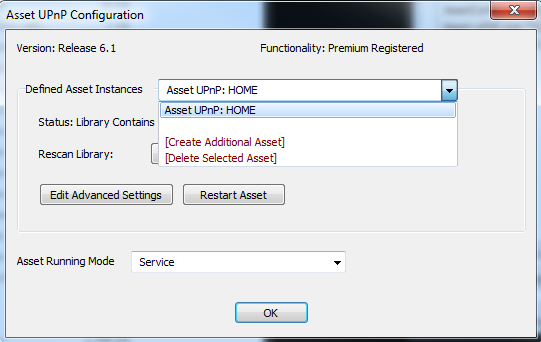

      When I run the Config I see my "HOME" account, then there is a blank space, then there is the Create Additional and Delete Selected options. When I highlight the blank space and wait a moment until it shows me "no files" then select Delete Selected Asset, it asks me if I want to delete Asset " so it looks like it's considering the blank line to be another instance? I confirm, restart config, blank is still there.
      Does this all look correct?
      When I go to msconfig I see under "Services" that I have one service called AssetUPnP
      When I look at Processes in Taskmgr I see two instances of Asset-uPNP.exe *32, one using 1,432K memory and one using 4,580K memory. When I right click and "Open File Location" they take me to the same file (Asset-uPNP.exe) in C:\Program Files (x86)\Illustrate\dBpoweramp
      Is it normal to see tow processes running with only one instance of the server defined?
      Anything else you can suggest checking or is everything here looking normal and thus the problem must lie with Heos?

        I included a screenshot of the config via postimage which is why the previous post is likely pending approval, just in case an unapproved post doesn't show the thread being replied to! Thanks.
        EDIT - I didn't even include the right screenshot, please see attachment in this post for the correct one showing the blank line.

          On the player it shows Asset: HOME twice?

            Yeah one with tracks and one with "No Media"
            Oddly enough, this morning I noticed no media in either so I went to the config and it showed no tracks either, I rebooted and went into "My Computer" and into my network (HOME) and I see two instances of Asset UPnP: Home in "Media Devices" also, even though only one when I launch ASset COnfig.
            Both in properties show 127.0.0.1
            But they have different "unique identifiers"
            Is that because I have more than one device using the Heos app (it's on my iPhone and my iPad)?
              • 46150
              Re: Multiple instances of Asset showing, tracks only found in one
              No, it is likely you have Asset installed to 2 different locations on the computer.
