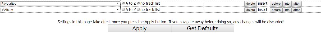

    I have added the following lines to AssetUPnPDefinedBrowseTreev6.txt:
    Favourites{_a_to_z_}{_no_track_list_}
    Favourites\Album
    Nothing appears in my control point, but the browse tree shows it there in the text version as above and as attached in the tree.
    I'm sure I'm doing something wrong but no idea what!?

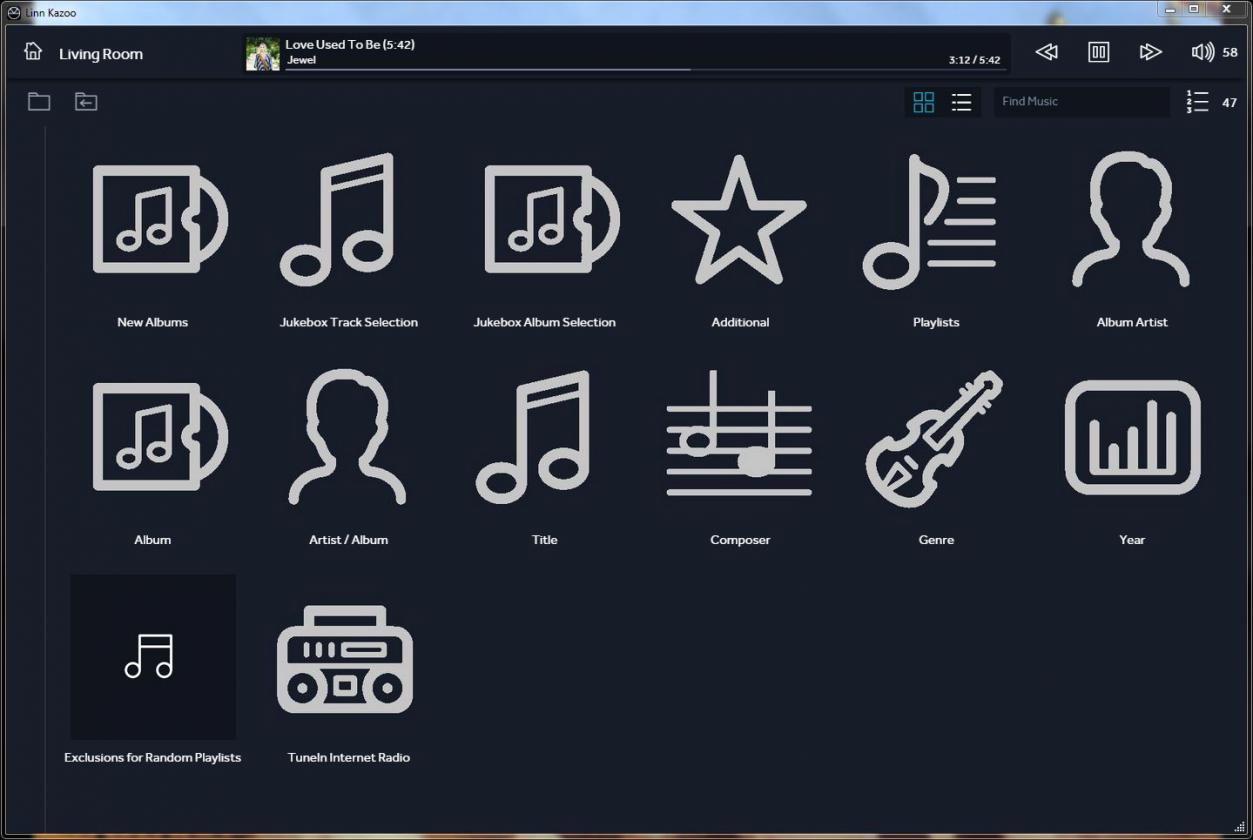

    Re: Problem Adding Custom Tag to QNAP Asset
    'Nothing appears in my control point,'
    Your control point does not show a favourites folder?
    • timster67
      • May 2014
      • 210

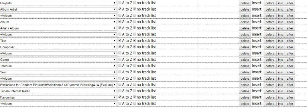

      Correct. Attached screen shot of control point top level, and more of Asset config browse tree, from Playlists down.

        • 46114
        Did you restart Asset?
          Aha! Should have done, but no just a "Rescan all" as per the instructions. Maybe update them to say that?
