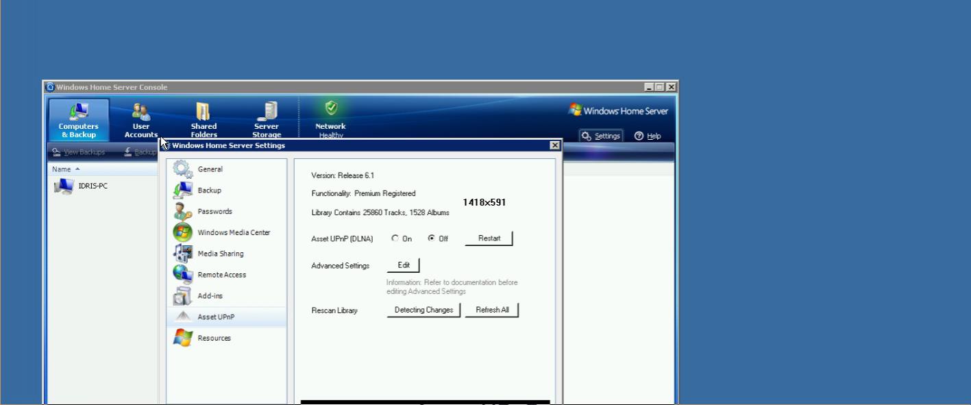

      I have attached an image.Click image for larger version
Name:	Asset Home Server.jpg
ID:	293972 This is from the setup screen on the assetnas (Running) as can be seen from the image, Asset is not running!
      If i altered the button manually to on, then asset would show on my control apps. This is the only way I can get asset to run, whereas this used to start automatically as soon as my AssetNAS was switched on.
      Would a new install of 6.1 correct the problem?
      Thanks again
        • 46231
        Re: Asset Not Visible On Control Point
        Try to uninstall Asset, restart the NAS then reinstall.
