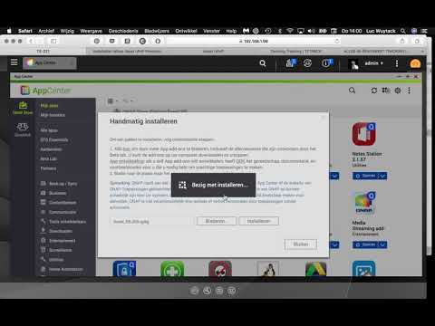

    I was trying to update from Asset uPnP trial v6.1 to the Premium version.
    Like suggested, I removed the trial, restarted and manually tried to install the premium version.
    I don't succeed in installing it. Nor does it make a log.
    The NAS is a QNAP TS-221, arm based...
    What could be the problem here?
    A while back I was able to install the trial version. But I don't remember if there was a QTS update on the NAS in between former installation and today's version.
    Some support would be appreciated?
    Thanx!

      Re: installation failure Asset uPnP Premium on QNAP NAS TS-221
      Nope.
      The (manual) installer on the TS-221 stops immediatly when clicking the OK button for installation.
      Still not logging, like nothing happened...
      I just payed 30 euro, so it would be nice to see it work

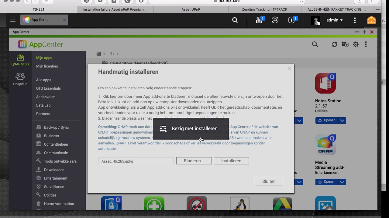

          Hi Peter,
          I changed the video's settings. It just demonstrates what happens if I want to install the Asset qpkg.
          Really nothing. Nothing to find...
          Neither the trial nor the premium version seems to succeed.
          I don't understand. A while back I installed the trial/free version...
          I still need your help please...
          Thanx,
          Luc
            • 1626
            Thanks for the info.
            Indeed it looks like the QPKG does not install on your device. Which implies that it is a problem with QPKG packaging process rather than Asset program itself. I'll get back to you with some alternate QPKGs to try soon.
                      I can't go to 4.3.4. The latest firmware version for TS-221 is 4.3.3.0644, installed 23 aug 2018. It is ARM based.
                      No matter wich version, the result is always the same.
                      So I chose your final solution.
                      I succeeded in SSH to install the Asset_R6.2b6-new.qpkg.
                      So I tried again with SSH to install Asset-premium.qpkg, and oh wonder... It installed! :D It runs now 6.1.
                      I don't know if proper installation of newer version(s) will succeed in the future via Qnap App center.
                      So maybe you still may find the solution?
                      How about future updates? Will I get a notification? Or do I need to check once in a while?
                      Already a big thanx for the support. I'm glad to have the Asset uPnP running again!
                      Kind regards, Luc
