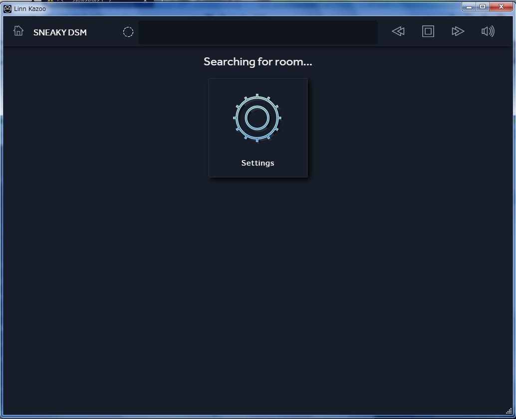

    NONE of the versions work properly.
    Especially, when 'v1' is installed, Kazoo on Windows does not work, icons other than 'Settings' disappeared (see attatched image).
    This state continues even if I stop asset, and it returns to normal after uninstalling.
    Kazoo on Android does not have this problem.
    v2 and v3 do not have this problem also, but album arts are not shown, same as before.

      I give up, I have no idea what is wrong, I'll be buying a TS-231 unit to investigate this bug in-lab. In meanwhile, please stick with the last version that worked correctly. If you are a registered user no longer have an installer for the registered R6, please drop me a message and I'll send it to you.
      If you have the technical skills to do this, I would appreciate if you could try Asset R6.1 for Raspberry Pi on QNAP TS-231 and report if it also has this bug - as the issue has not been reported on the Raspberry Pi. You will have to use _APPDATA_OVERRIDE env var to point Asset to use a folder with plenty of free space on the device, as the QNAP home folder is usually some 64MB RAM disk not sufficient for us, eg. _APPDAT_OVERRIDE=/share/HDA_DATA ./AssetUPnP

          Re: Album arts are not shown
          Status update
          QNAP TS-231P up and running, bug reproduced, fixing.
            • 1656
            Current version: R6.2 beta 15 Downloads: <now released> (Synology link until it is published) http://www.dbpoweramp.com/beta/Asset-R6.2b15.spk Changes since R6.1 Fixed AAC decoding on QNAP with 64-bit ARM processors. Warning on corrupted database file, shown when accessing web config. Standalone builds for ARM64
            R6.2 beta 2 works properly on QNAP TS-231P.
            If you upgrade from R6 to R6.2 you should not see this bug again. If you upgrade from R6.1 and have this bug, do a "rescan all" cycle with R6.2.
