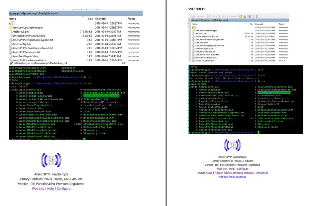

              Re: Raspberry Pi3 Asset Questions
Name:	before and after reboot1.jpg
              Here is a picture showing before and after reboot.
              Any idea why this is happening?

                  • 1597
                  The folder where your Asset configuration is placed must be on some kind of a RAM drive that does not survive reboots. You need to redirect it somewhere else. For an example, to the same folder where your Asset binaries are located.
                  Use the _APPDATA_OVERRIDE as shown in my post above to choose another folder to store your Asset data.
