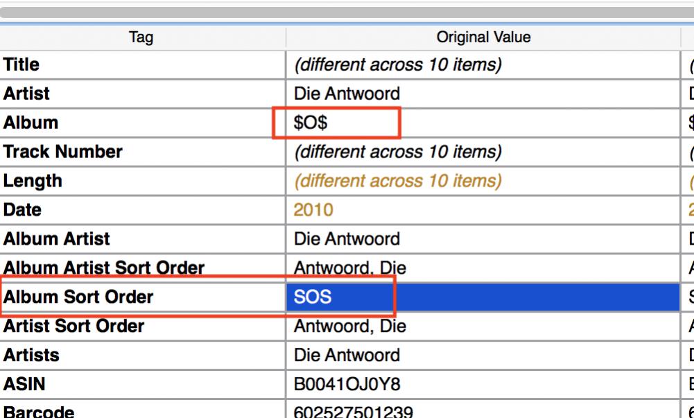

      Here's a screenshot from MusicBrainz Picard:
Name:	Screen Shot 2018-01-22 at 11.11.55.jpg
      With MP3 albums, this works as expected.
      For the FLAC albums, these tags are recognized by Audirvana+ (which reads the filesystem directly), so they should be set up correctly.
      Sebastian

          Re: ALBUMSORT tag in FLAC ignored?
          When using MusicBrainz Picard, I can only add a tag named "albumsort" which translates to the "Album Sort Order" tag shown in the screenshot.
          This seems to be the same for FLAC and MP3, but I'm not sure if this is just an abstraction layer which translates to the correct filetype-specific tag in the background.

            Sadly, there is no tagging naming standard across different softwares.
            I use MP3Tag, in which I map the vorbis comment (flac tag format) Album Sort tag to to AlbumSort, so I see AlbumSort in the app for both flac and mp3 files, but it writes Album Sort to flac files, which is used by asset.
            See here: Picard Tag Mappings
            It looks like MusicBrainz Picard is writing AlbumSort to your flac files and not Album Sort, as used in Asset. You don't need new software, just setup your preferred mappings, for vorbis comments, in the MusicBrainz Picard app.
              Thanks! I assumed that the set of tags and their names were standardized across the file formats.
              After browsing through Picards preferences menu, it doesn't seem to be possible to change the tag mapping.
              Apparently one can specify free text tags, so I tried to add "Album Sort" to one album and "ALBUM SORT" to another.
              After a full rescan in Asset, both albums show up as "(Unknown album)" - now that went well
              I think I'll give MP3tag a shot...
                Ok, I finally got it using MP3Tag.
                For some reason I needed to remove all "non-essential" tags from each of the affected files or Asset would only display them as "(unknown album)", even if I removed the album sort tags I added before.
                I must have broken something during the process. Very weird.
                Anyway after rewriting all tags with Picard and adding "album sort" with MP3Tag, my albums finally show up at the right place
                Thanks!
