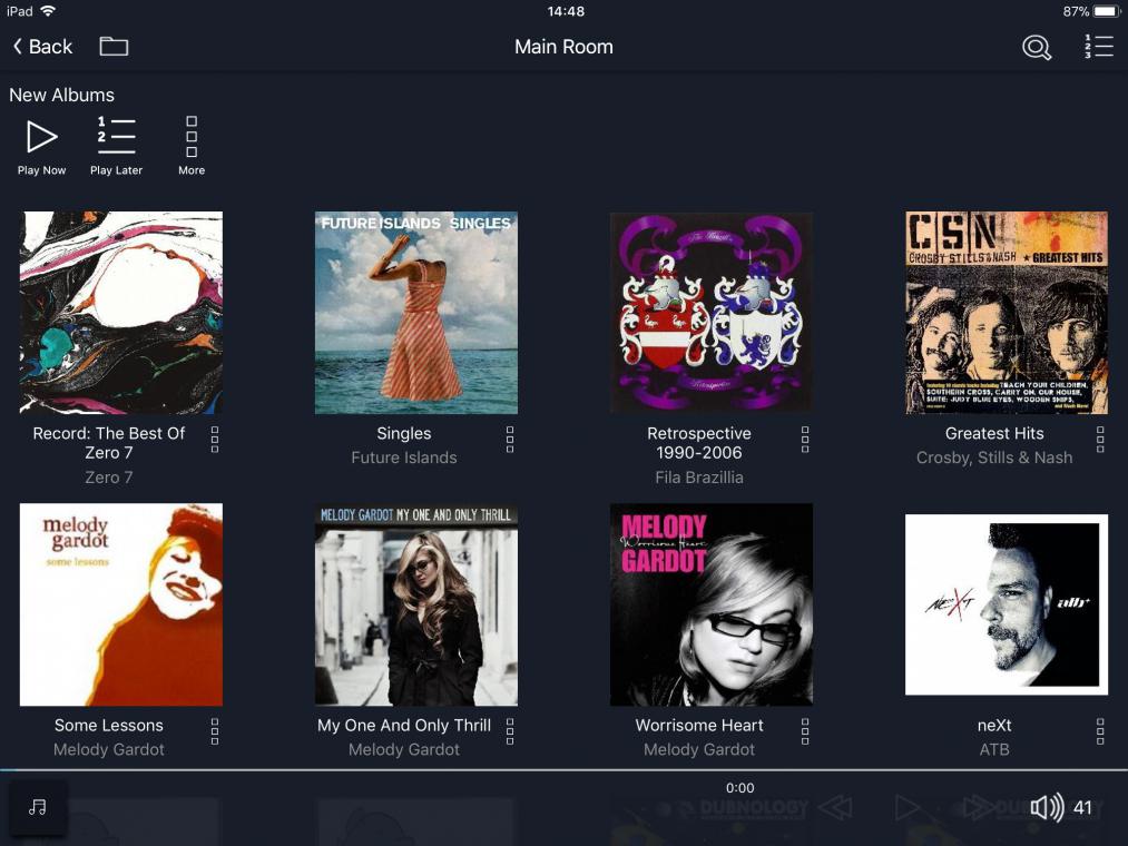

                  New albums gives the attached:-

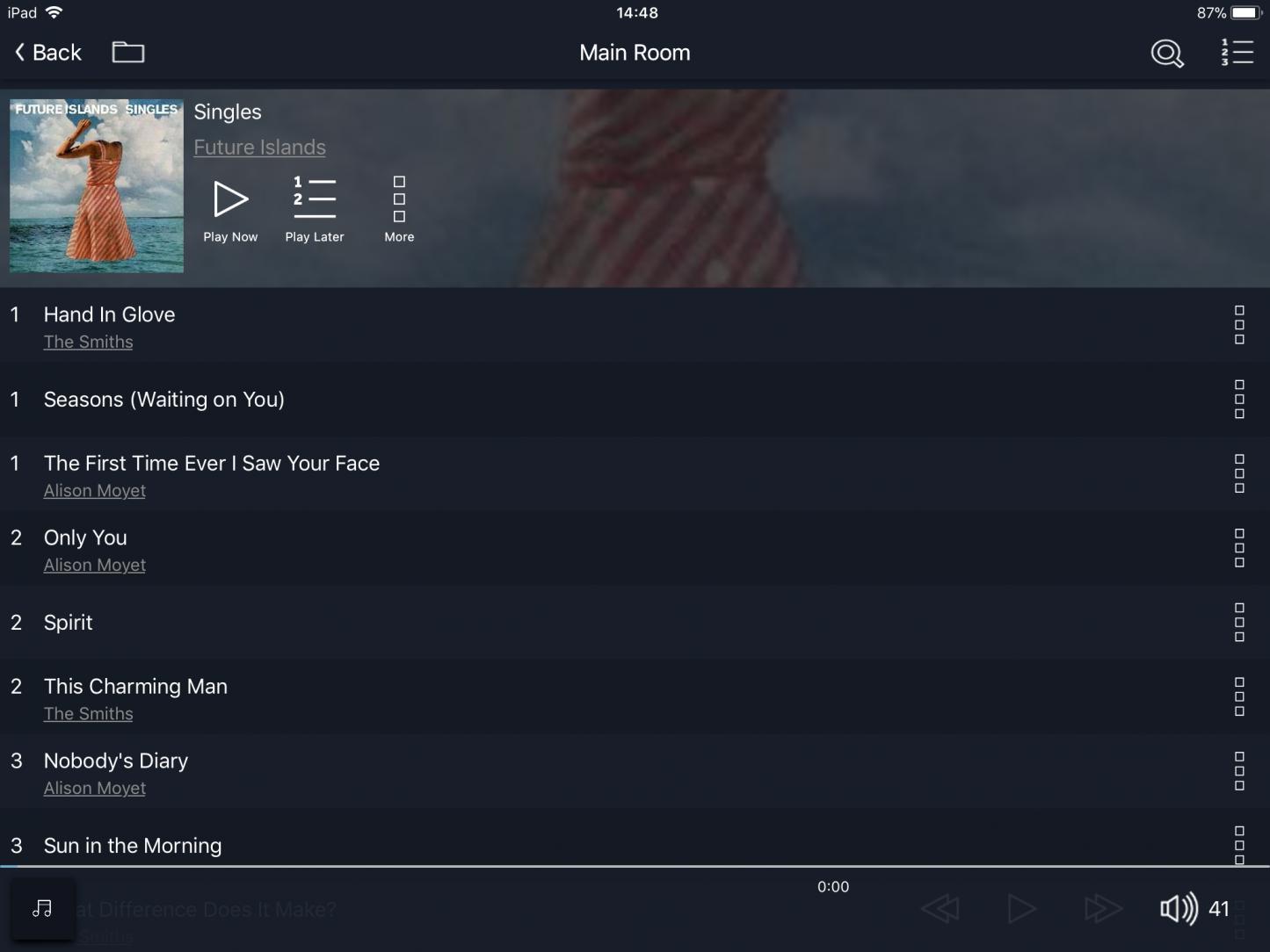

                  When I then go into the Future Islands album I get:-
