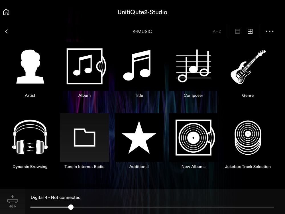

    I’ve just downloaded R6 for for use on my Mac Mini. The new interface is just great - and I really like the multiple instance facility - superb for dedicated music libraries!
    When viewing on a tablet (via Naim app on iPad Mini2), the main UPnP Asset icons are very pixelated (as per screen shot) and seemed to show in low res. The rest of album artwork / icons appear as correct res. Can the icon be user changed with a higher res PNG image? I’ve done this in the past in R5 with a custom icon and have tried in R6, but am completely stumped as to how to change the opening Asset icon to a crisp sharp version.
    I’m familiar as to how to replace the browse tree icon images in the AssetImages folder with my own designs, and will probably do this with new PNG versions of my current JPEGs, so i’m happy to go hunting in the Asset Bin Folder etc.
    I’d be really grateful if someone could please help!

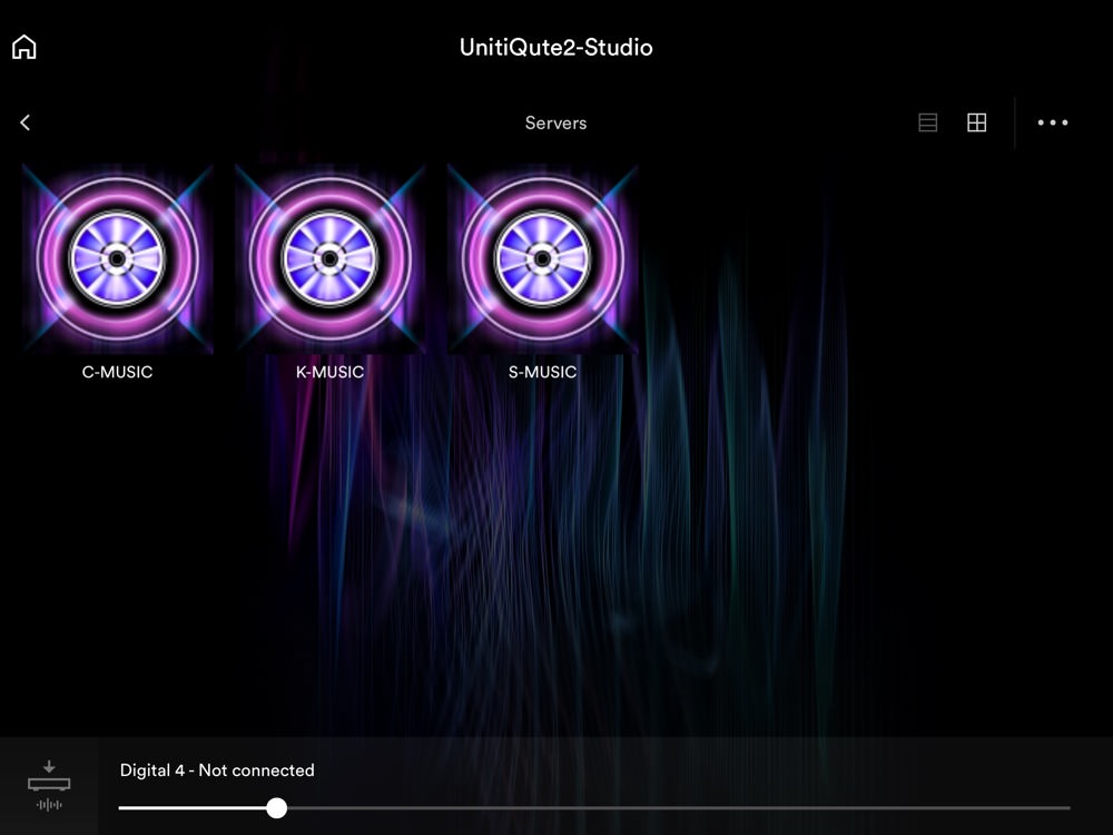

          1. Swapped my custom R5 JPEG Browse Tree icons to reformatted PNGs and dropped them into R6 - worked like charm and have pin sharp custom browse icons (see link).

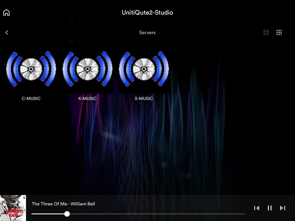

          2. Swapped out the original Asset icon with my own quick variation. This new image is some 500x500 pixels in dimension, so should be pin sharp as it was when I did this in Asset R5, but no joy, the image is still blurry on all three current UPnP Instances. As before in R5, the icon file was renamed to asset-120x120.png and placed in the Asset Bin folder. This worked to a point, as the new icon is visible (see link), but for some reason OSX keeps losing / deleting the .png file name extension - and the image is still fuzzy.
          I am completely stumped as to how to make this opening image sharp, and looks really poor on an tablet screen - wondering if its a quirk of R6 for Mac?

                      Thanks for your feedback. The Asset Logo appears ugly due to an error on my side, I did not copy a new larger/tweaked logo PNG from the Windows codebase. This will be fixed for the next update.
                      Temporary workaround:
                      Mac version:
                      In Applications, right-click Asset UPnP.app, "show package contents", navigate to Contents / Resources / bin
                      Replace asset-120x120.png with the image attached to this post.
                      Linux versions:
                      Locate the folder with your Asset binaries, replace asset-120x120.png in it with the attached image.

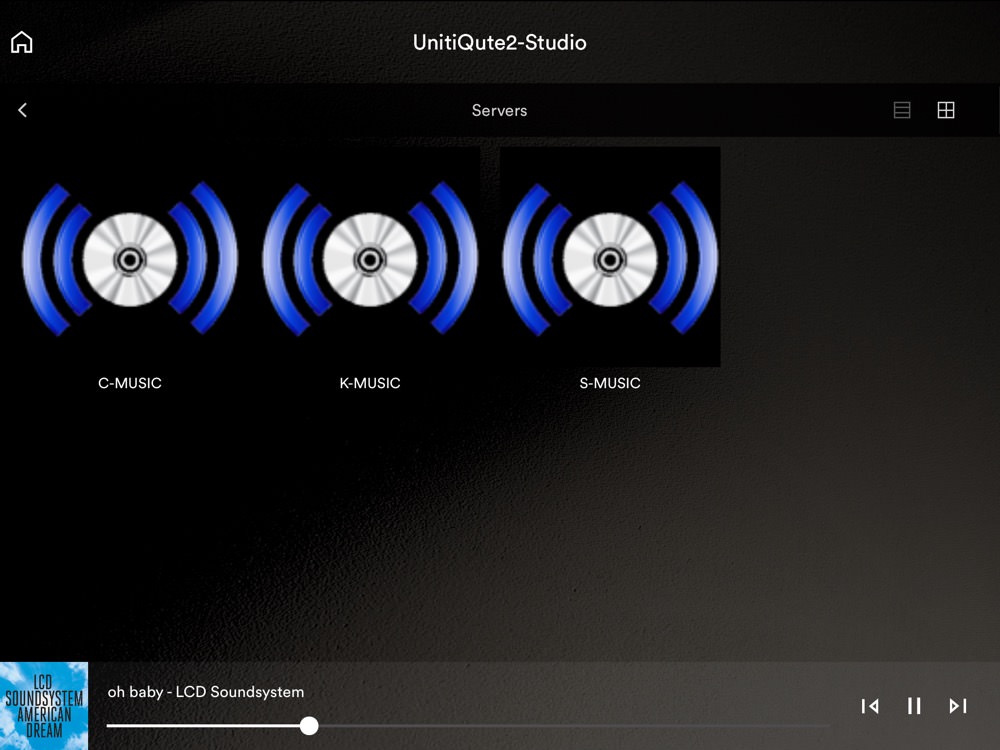

                        I did the temp workaround, but the image is still blurred when the icons are set to the medium size and viewed on phone or tablet (attachment).
                        I have tried using my own icons at different dimension with the same workaround - up to 750 pixels square, naming the image asset-120x120.png in each case. Also at higher pixel density of 150 and 300 dpi, and yet they all show as blurred, even after restarting Asset, the computer and resetting the Naim app & image / UPnP cache?
                        In R5 this icon could easily be user changed in the same way to a higher res version, then displaying as ultra sharp on all control devices?

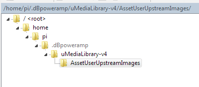

                              So this is the location of the folder "AssetUserUpstreamImages"
                              Do you have this folder?
                              It could be that Asset R6 for MacOS doesn't include this feature.
