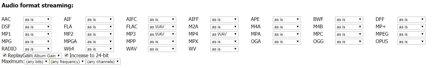

      Th pre-amp settings are missing in my QNAP version of Asset. This is all there is:
Name:	Asset Audio format streaming settings.JPG
      Does this matter?
        [ATTACH=CONFIG]1929[/ATTACH]
        Does this matter?
        It means that currently, you can't adjust the target volume. It may or may not matter to you.

                    I think I have found the pre-amp gains. They seem to be within general settings called "Additional gain with ReplayGain (dB)" and "Additional gain without ReplayGain (dB)". I presume this is equivalent to the pre-amp Active and Inactive settings you have?
                      • 1656
                      Re: Replay Gain basic questions
                      You are correct.
                      In Linux/QNAP versions of Asset, using the web configuration interface, the gain settings are in the general settings table, rather than grouped together with streaming options, but they are the same things.
                      We'll try to make these more consistent with other versions of Asset in a future update to prevent confusion.
