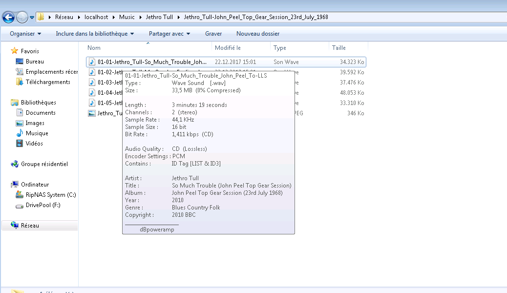

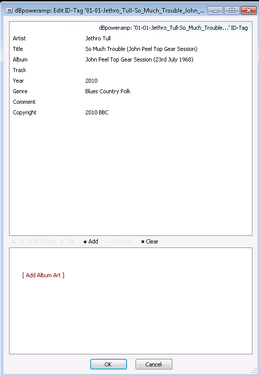

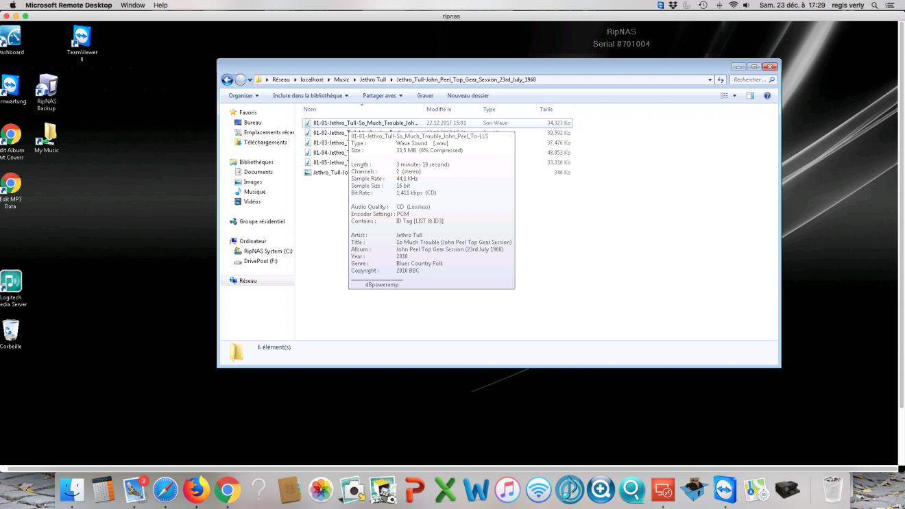

                Re: Pas de numéro des piste sur les fichiers WAVE téléchargés
                The metadata seem to me complete .I have 2 screenshots of downloaded dataClick image for larger version
Name:	Capture d’e?cran 2017-12-23 a? 17.30.01.png
ID:	293786Click image for larger version
Name:	Capture d’e?cran 2017-12-23 a? 17.29.41.jpg
                  Originally posted by HERVE 78
                  The metadata seem to me complete .I have 2 screenshots of downloaded data[ATTACH=CONFIG]1918[/ATTACH][ATTACH=CONFIG]1919[/ATTACH]
                  There is NO Track tag. See my post no. 2 and use Edit ID-Tag to add the Track tag.

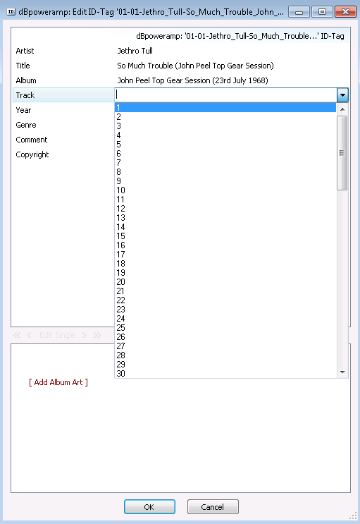

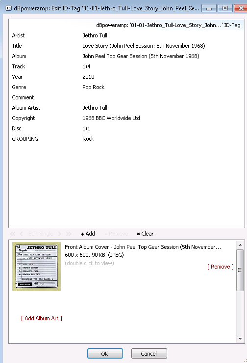

                    Hello mville
                    As I said, I have already manually tagged the track numbers, but the player does not read them any more
                    In the screenshot example, only tracks 3,4,5 are played, tracks 1 and 2 are not playedClick image for larger version
Name:	Capture d’e?cran 2017-12-24 a? 12.06.03.png
ID:	293789Click image for larger version
Name:	Capture d’e?cran 2017-12-24 a? 12.06.35.png
                    I tried to assign the numbers just 1,2,3, ... etc or ratio 1 / 5 2 / 5 3 / 5 ..etc it's the same thing
                    When I want to change the genre, it's the same phenomenon, all the tracks are no longer read .Interesting? but especially depressing

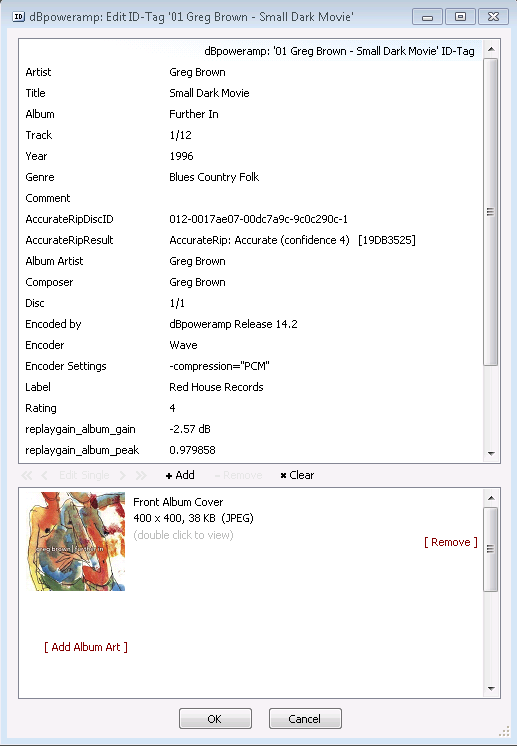

                    Here is the screenshot of a ripped CD that works properlyClick image for larger version
Name:	Capture d’e?cran 2017-12-24 a? 12.11.45.png
                    I remember that these difficulties are met only with the file downloaded in Wav, with Flac no problem
                    I can not find the solution, which must exist, because the other software manage to read correctly the numbers of tracks
