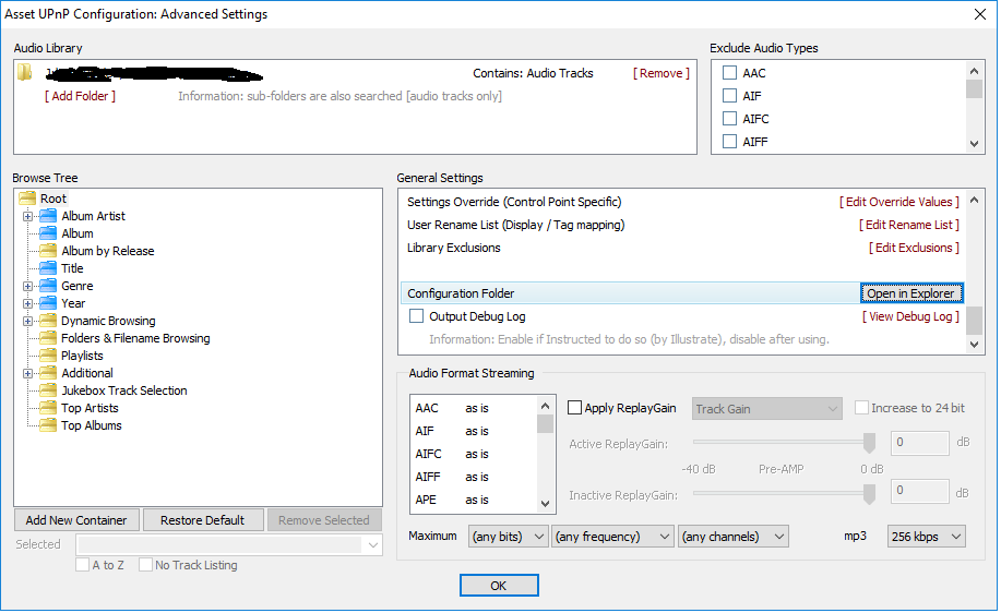

        I do have access to :
        "C:\Windows\SysWOW64\config\systemprofile\AppData\ Roaming\dBpoweramp\uMediaLibrary"
        On the other hand, I found that you facilitated us finding that folder using the "Asset UPnP Configuration, Advanced settings" program, which shows a link to the configuration folder:
Name:	Asset Config tool.png
        pointing wrongly to:
        "C:\Windows\***System32***\config\systemprofile\Ap pData\Roaming\dBpoweramp\uMediaLibrary"

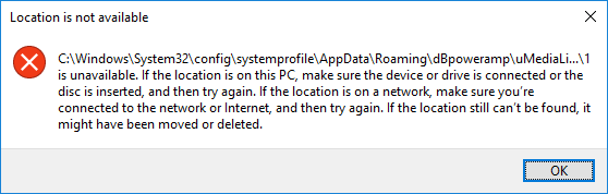

        Clicking that link pops up an error:
Name:	Asset Error Msg.png
        Your earlier response is correct, but the link that the configuration tool tries to open is invalid.
        Last edited by PatatiPatata; October 22, 2017, 04:20 PM. Reason: Fixing the attached images
          • 46219
          Re: Clearing Asset Upnp settings - COMPLETELY
          This is because Windows silently maps System32 to SysWow64 because Asset is a 32 bit program, for all intents Asset thinks it is writing to the System32 folder.
