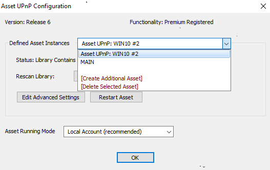

    This is what the configuration panel shows after
    creating the third instance:
    MAIN is correctly shown with correct number of tracks and albums.
    The entry "Asset UPnP: WIN10 *2" seems to be an empty one.
    No Folder has been added.
    The instances MUSIK2 and LAGER are missing
    although they are running, shown by Control Points and usable.
    I restarted the system but nothing changed.
    All instances are running correctly but the Configuration Panel shows rubbish.

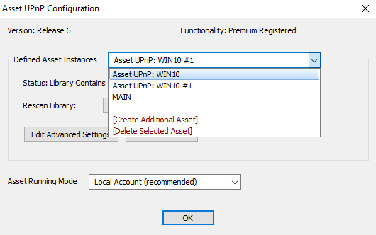

      After creation none is running
      - click on "Refresh all"
      nothing happens
      - click on "Detecting changes"
      nothing happens
      - click on "Restart Asset"
      now the first instance MAIN is started
      Status: 0 tracks 0 albums
      - click on "Edit Advanced Settings" while MAIN is active
      no folder has been added, identification has been reswitched to "Asset UPnP: WIN10"
      the program seems to have forgotten the settings

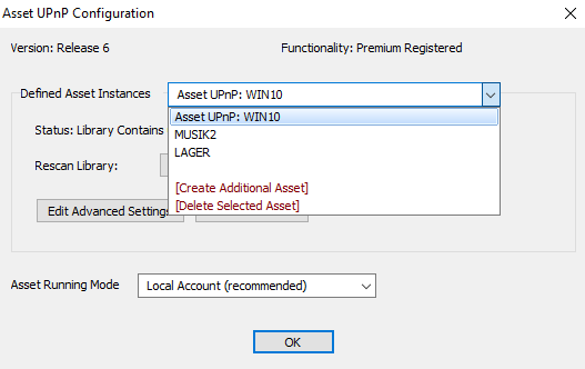

      - selecting MUSIK2
      Status: Not Running

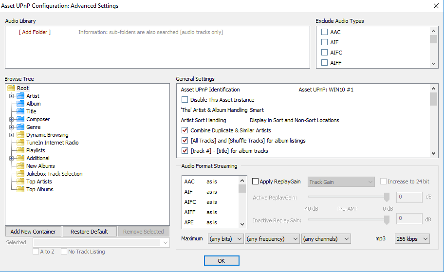

      the same: no folder has been added, identification has been reswitched to "Asset UPnP: WIN10 *1"

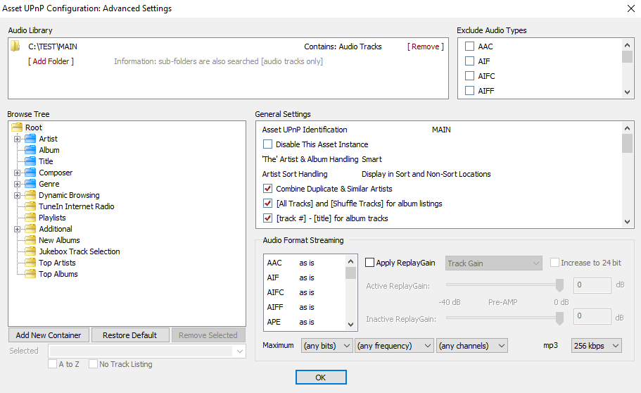

      - selecting LAGER
      Status: Not Running
      now it gets very strange:
      LAGER seems to have the values of MAIN. MAIN's folder is shown and MAIN as identification
      - when leaving the settings MAIN is shown instead of LAGER -> LAGER has become MAIN

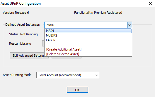

      all instances seem to have been started now:
      "Asset UPnP: WIN10" and "Asset UPnP: WIN10 *1" are still empty
      but MAIN shows 1 album 12 tracks which is correct
      - renaming "Asset UPnP: WIN10" and "Asset UPnP: WIN10 *1" to MUSIK2 and LAGER and readding the respective folders
      both want a restart when clicking on OK, afterwards they show the correct tracks and album
