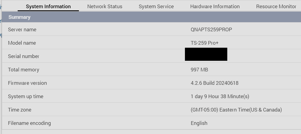

      Hi, I had been running an older version R2025-04-03 (beta) (registered from version Asset-QNAP-2023-05-15) on a older QNAP TS-29+ (OS ver. 4.2.6.20240618) without issue.
      I decided, it had been a while so I upgraded to the new 2026-07-29 version that just happened to be release the day I looked.
      The installed worked and it shows as 'running' in the Qnap app manager, but the web interface does not show, it just errors as not there.
      I tried to redo by removing it, installing Asset-QNAP-2023-05-15 and then a beta I had Asset_20241009b (i can't find my R2025-04-03 (beta) version and then upgrade again to 2026-07-29. Same issue.
      I then removed and tried just 2026-07-29. Same issue.
      Each install and removal had a reboot between.
      So for now, I just reloaded Asset-QNAP-2023-05-15 and then R2025-04-03 (beta), so it can work until this new version is debugged.
      Please help / look into. Let me know what you need.

          • 1658
          Please confirm the QNAP model you're running, they're usually named TS-XXX (three digits), I can't find anything on TS-29+
          If it's running OS ver 4.x it must be old, but I tested my own old QNAP running 4.x and found no issues.
          What processor does it have? Check system information in QNAP control panel.

            Opps, somehow the model digits dropped.​ See attached. Yep, it's an older one, but still working great for this type of service. Processor per spec is a Intel
            • Gecko970
              • Jul 2026
              • 5
              Processor per spec is a Intel 1.8 GHz dual-core Atom CPU. Released in 2010,and x64 chip but with Qnap OS at 4.2.6 within is a x32 OS only. I know the R2025-04-03 (beta) was working. Depending on what you find, could you provide link to download the R2025-04-03 (beta) version ( somehow i forgot to save it in my achive or it update within itself) and any version between it and the new 2026-07-29 build? I can try them and see where it breaks. If you need anything from unit, let me know. Thanks.
                • 1658
                Okay, good news is that I have this very exact model (TS-259) stored away and will verify Asset on it shortly. Bought it to be able to test Asset on 32-bit Intel QNAP...
                I use mine as a backup server, installed 64-bit Debian on it to get latest security updates.
                It works like a normal PC once you connect a monitor and a keyboard to it, can enter BIOS, disable hidden QNAP boot volume and install any operating system you like on it.
                Likely problem cause is that I upgraded GCC compiler to latest, it might be doing something in 32-bit code that the Intel Atom CPU doesn't agree with.
                  • 1658
                  New version up, problem fixed.
                  A few months back I removed x86 32-bit binary from QNAP/Synology packages to reduce download size, assuming these devices to be extinct, then forgot to mention it in change logs.
                  • Gecko970
                    • Jul 2026
                    • 5
                    Peter- That fixed it! I appreciate your re-adding x32 back in just an case for a few older HW users like me. I keep using this old NAS as it keeps working and fits by my backup / music serving needs. I was going to upgrade to a current NAS model ( a larger unit with new HDD's NvME Cache etc. this year but with memory and HDD prices, I'm holding on for now. Please retain the x86 support. Thanks again!
