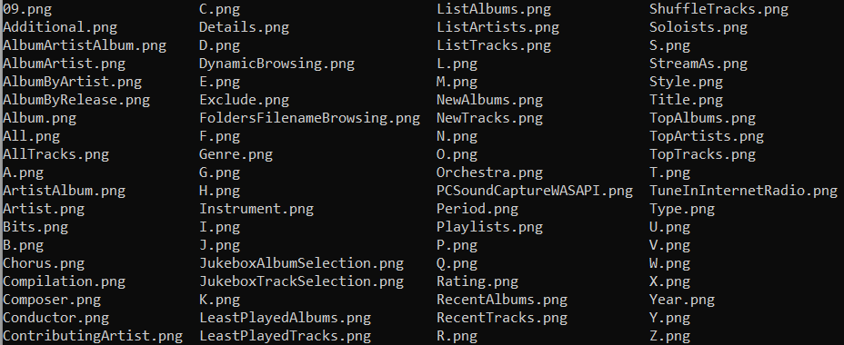

    I successfully replaced the A to Z and 0-9 browse tree images with my own (I don't like the default bold rounded font style). However, the asterisk is giving me a headache. I tried all kinds of logical names, no success. I looked up the image names on the server (Synology NAS / DSM 7) and tried several (like All), but that didn't resolve the problem. The asterisk image is not replaced. Is there an official list we can use to replace all the default Asset images?

    These are the images on my server
    • 46150
      But that doesn't work for some reason. All the other images change after the automatic restart (I use the same file with a different name), not this one.

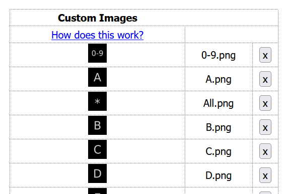

              It would be a shame if that's necessary as it would defeat the whole idea of easily replaceable images. Are there perhaps other file names I can try? I noticed for example 0-9.png works for 09.png. Could it be a system limitation?

                It's supposed to take "All.png" or "All.jpg", but for some reason it doesn't.
                I'm investigating the issue, thanks for reporting.
                  • 1645
                  Update,
                  It currently takes "AllArtists.png" and so on, substitute different tag names for other contexts.
                  I'm changing it so it also looks for "all" if "AllArtists" etc are not found.

                    Yes! That works. Thank you.
