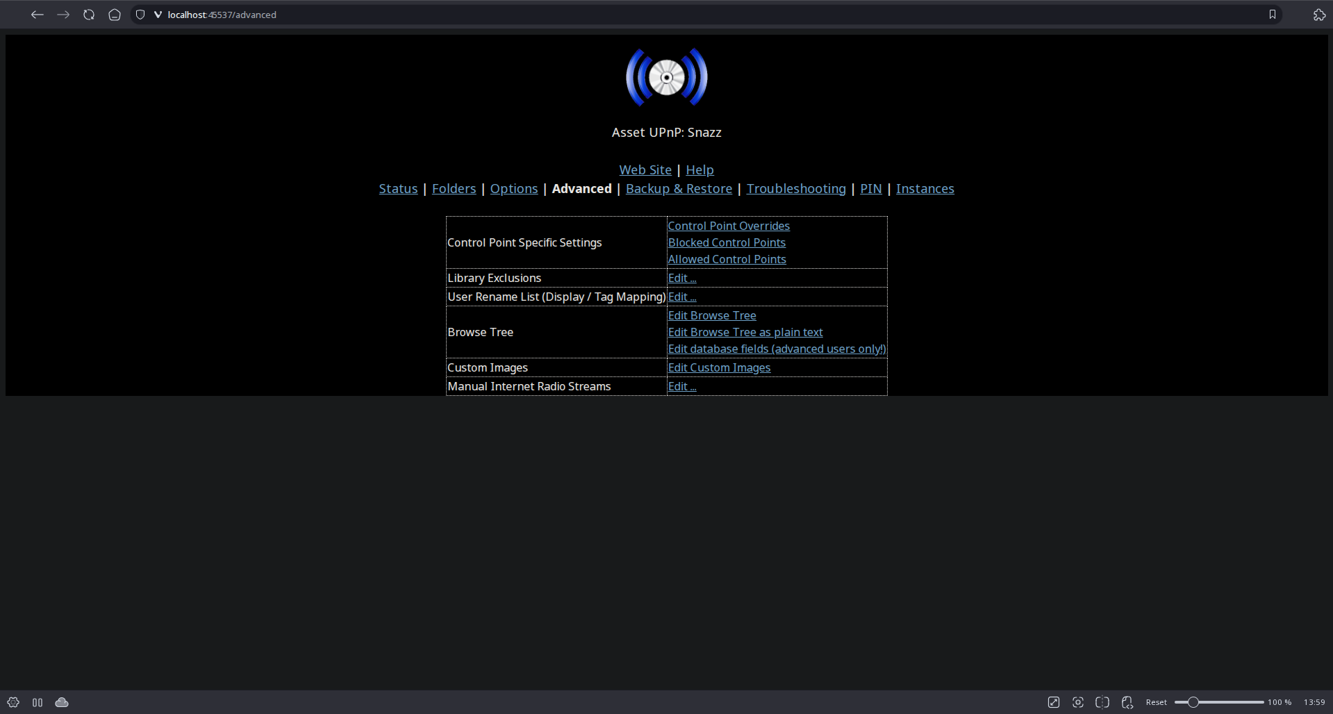

                    Again, if it's helpful to others: I've attached a screencap below of how my instance of Asset appears on Linux. It would seem that this is the intended layout. As such though, I don't know where I would find the path you suggest above? That said, without my having explicitly added anything, the preformatting of "originaldate" is working fine!
                    Asset server configuration page
                      Advanced > Edit database fields, though as you've pointed out it doesn't seem necessary at present (tested on Windows and Linux).
