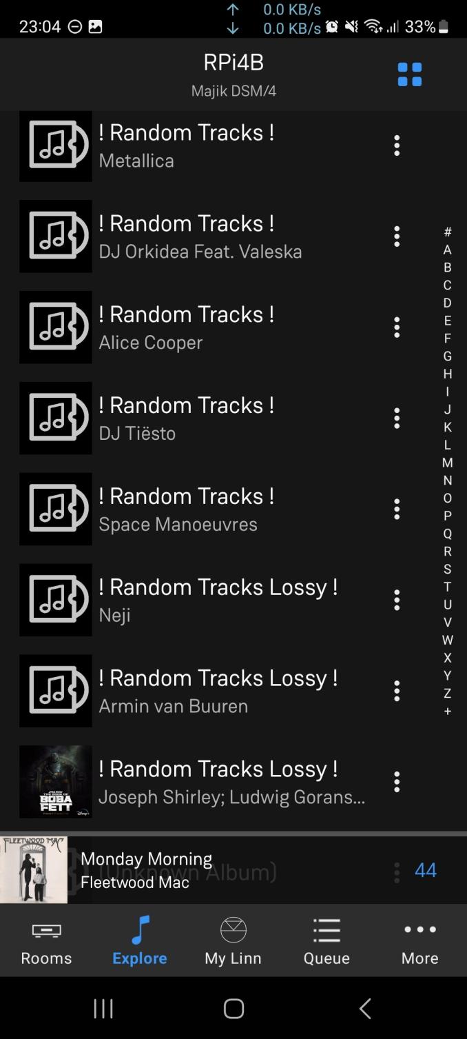

    i made this dumb album called !random_tracks! where i just dumped all the songs i did not want to get the whole album for.
    the purpose being having them all in one place, easy to find... and a replacement for unknown album, because i wanted my list to start with it.
    so somehow asset is displaying the !random_tracks! albums tens of times, each time with one song. i saw that on the presentation page as a feature..
    can i have the DUMB behavior to just group all the tracs with same album name under one entity?? does not matter what the artist or cd number or whatever is. i just want to through a bunch of tracks in one easy to spot bucket.

      that is what i did, i edited the tags, and used the same name in the album field. files are NOT in the same folder though.
      still i see a lot of entries.. i think it correlates with artist name, and makes a new entry for each different artis id3 tag entry.
      i also have albums with tracks numbers split in 2, with tracks 1,3,4,5 on one album, and 2,6,7,8 on another.. strange...
      again in album grouping, i would just like it to process the album id3 tag, and group all the files with same value under same entry.

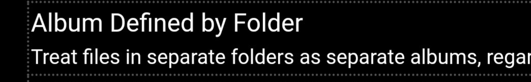

        • 46150
        "files are NOT in the same folder though."
        That is an option in Asset, Album defined by folder, as well as the tag.
        • misha0209
          • Nov 2025
          • 16
          you mean this?
          setting it to no seems to merge the unknown album tracks, but not the random tracks album items, those are still split.

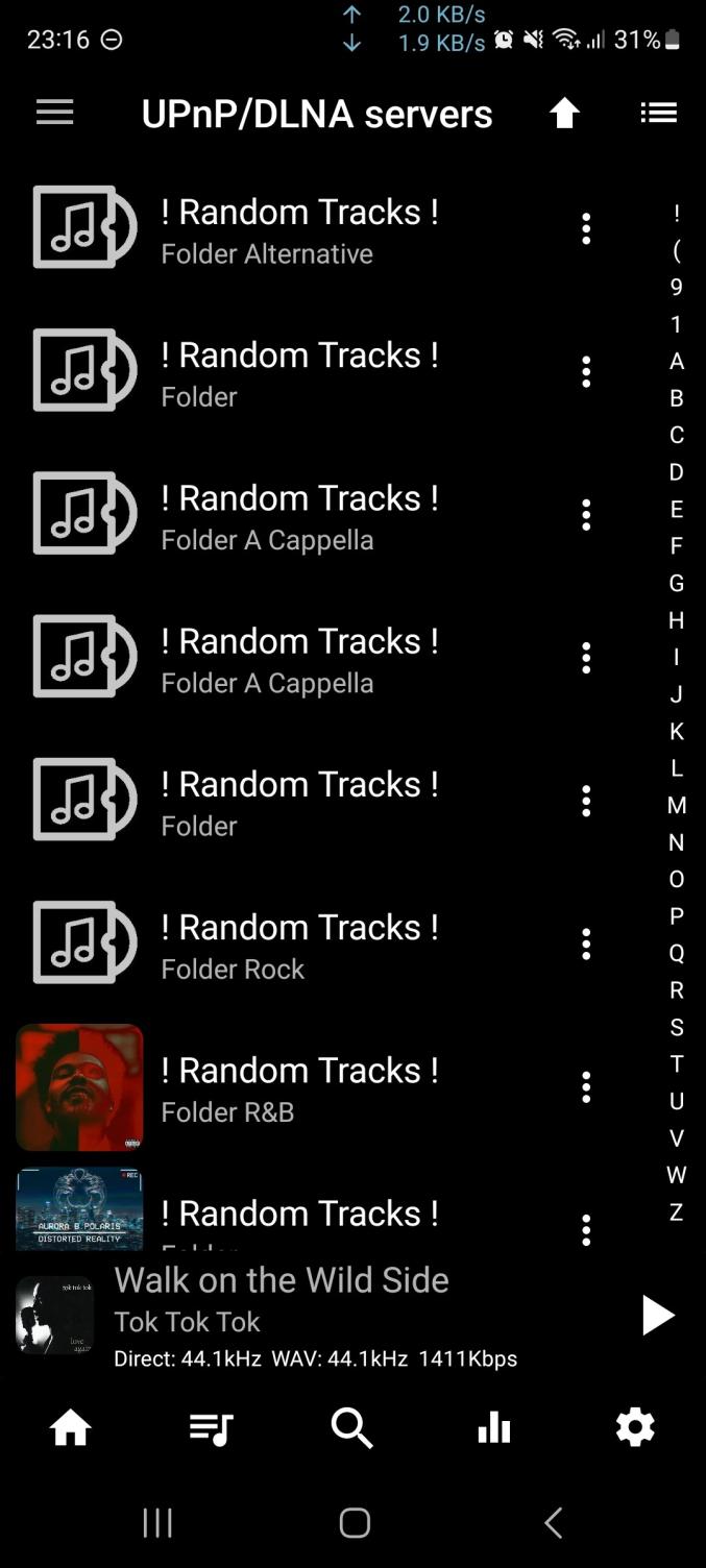

            interesting i have a random tracks lossy, and here, except 2 items they are all under one instance.
            so in the image, entry 1 and 3 of random tracks lossy are each one song. whike entry 2 holds many songs.
            there are still multiple random tracks entries, but, some are now grouped! so there are ebtries now with more than one song. but most hold a single song...
            • misha0209
              • Nov 2025
              • 16
              on another app it now has a commend that says folder trance, folder rock, etc...
              is it now grouping by genre? it seems to.be doing it's best to tell items with same album tag apart. can i not disable this behavior? and just have it dumb down and group by album name tag alone?

                      EDIT: I missed the bit where you said they're not in the same folder as that does split them up. I'll test some config changes.
                      EDIT2: Changing 'Album Defined by Folder' to 'No' fixed the split.
