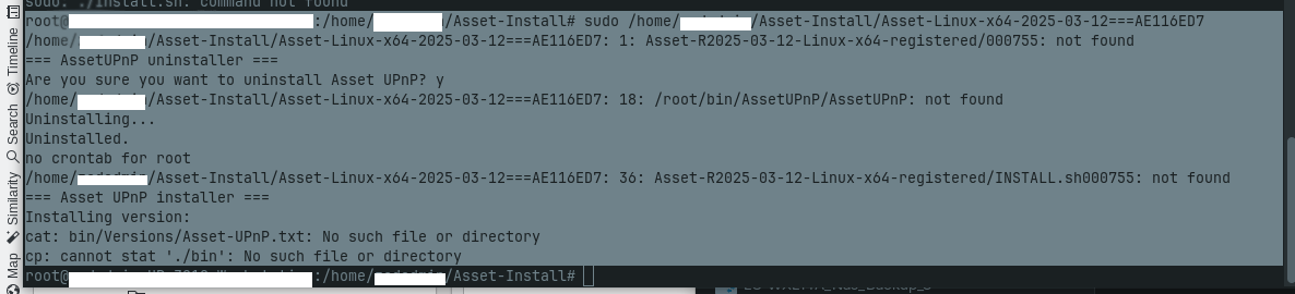

    Hi there, I'm following the steps in > Asset UPnP for Linux instructions - x86, Raspberry Pi ond I'm stuck with what I think is a permissions issue in ZORIN.
    Firstly, I needed to specify the complete path for the terminal to do anything, even though I was using 'root'. The downloaded file is extracted and has the 'run as a program' enabled. But I get this responce.
ID:	335094​It's probably something silly but I don't know where to look. I assume the download was fine since it opened, and being 'root' should mean I have the correct/necessary privileges.
    But the line about "no crontab for root" is weird. because in the installation steps doc (mentioned earlier), it mentions that using the crontab (whatever the hell it is) is not required now.
    so I pointer plzz, for this oldie/newbie trying out something new to replace win10 at home.
    cheers CD

    Hi there
    Answering my own Q.
    Looks like with Zorin the root is not enough, I had to use "sudo su" before the install would complete.
    cheers CD

          yikes!
          • doobre
            • May 2006
            • 77
            Originally posted by doobre
            yikes!
            === Asset UPnP installer ===
            Installing version:
            cat: bin/Versions/Asset-UPnP.txt: No such file or directory
            cp: cannot stat './bin': No such file or directory
            there is no folder named "/bin/Versions/...."
