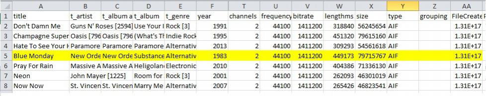

    When I looked at the dump file the column exists but not data is being pulled. The column is empty. If you like I could send you the dump file and the MediaDatabaaseFieldsv5 file if that would help.

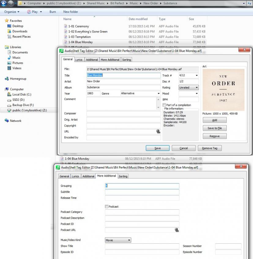

          Here is are some screen shots
Name:	ID Tag Screen Shot.jpg
Name:	AssetDump Screen Shot.jpg

            These aren't dBpoweramp Edit ID-Tag screenshots. Do you have dBpoweramp Music Converter installed?
            ... further digging around and I have discovered that the Audioshell Grouping tag uses the conventions used by Tag&Rename.
            The tag names used by different softwares is not standardized. I think the Tag&Rename/Audioshell Grouping tag is called Style in dBpoweramp/Asset and this tag is already predefined in the MediaDatabaseFieldsv5.txt, so you don't need to add it.
            If I am right, all you need to do is Launch Asset UPnP Configuration >> Advanced Settings >> Browse Tree
            and select the Style node/container from the dropdown list.
            Last edited by mville; February 04, 2016, 02:57 AM. Reason: audioshell/Tag&Rename discovery

              You nailed it! I have been using iTunes to rip the CDs and was just using Audioshell to view the tags.
              I now see my music collection as I wanted using the Styles container. Thanks guys.
