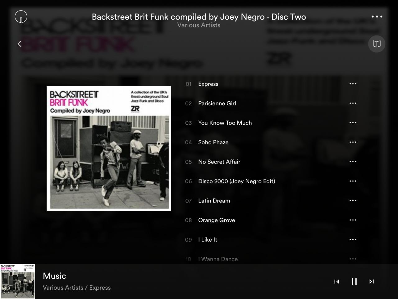

    Hi all,
    i have been using Asset for quite a while. What I have never got to the bottom of is (two pictures attached) shows asset which does not show the artist and "other" UPnP does. How do I get asset to show this?
    Also, is there anyway of seeing most recently ripped cd's in asset?

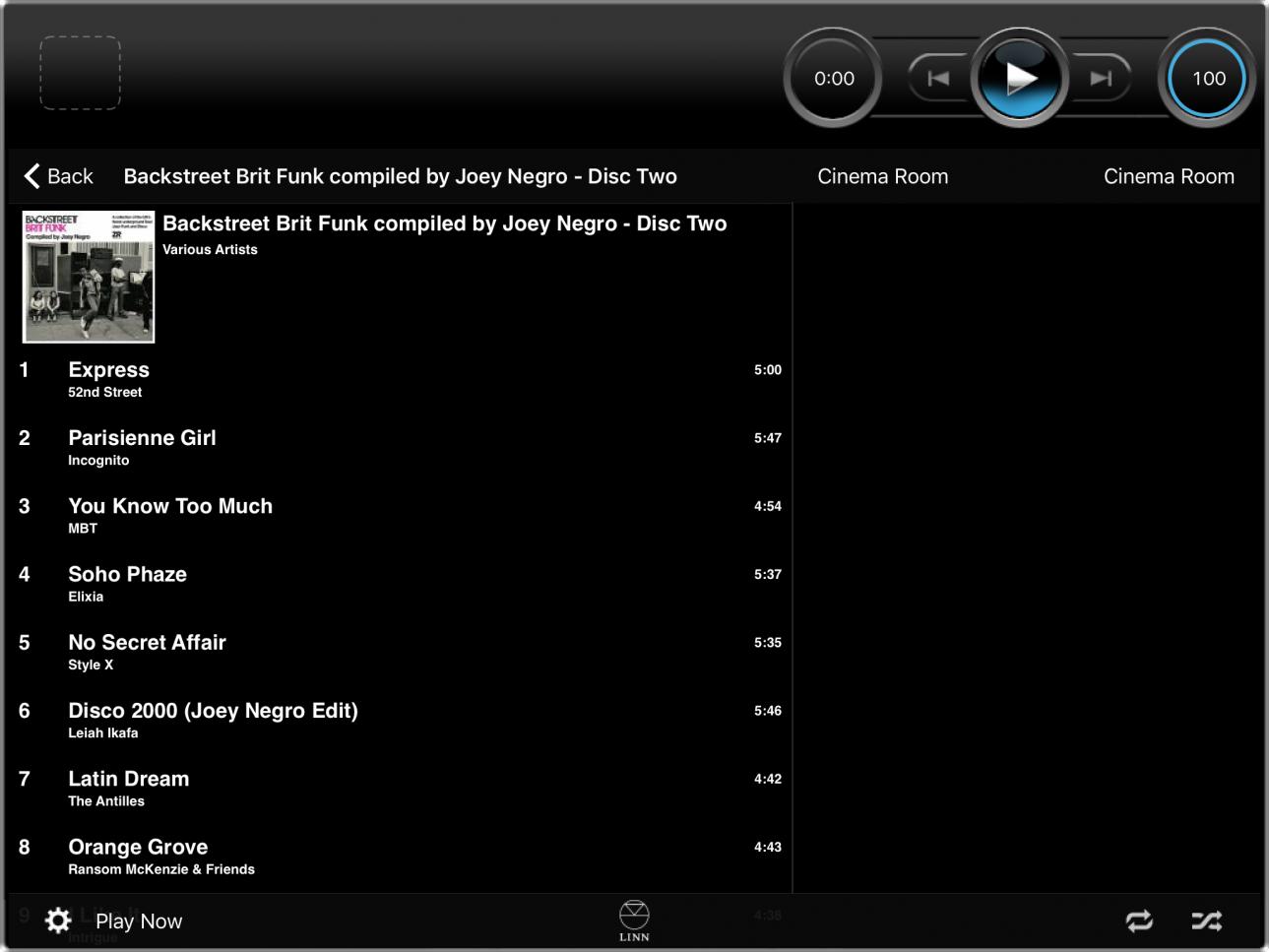

              Hi Spoon,
              Please see attached. What is interesting is that I can see it correctly through Naim app on both Kinsky and "other" UPnP and yet not through Naim app through Asset?

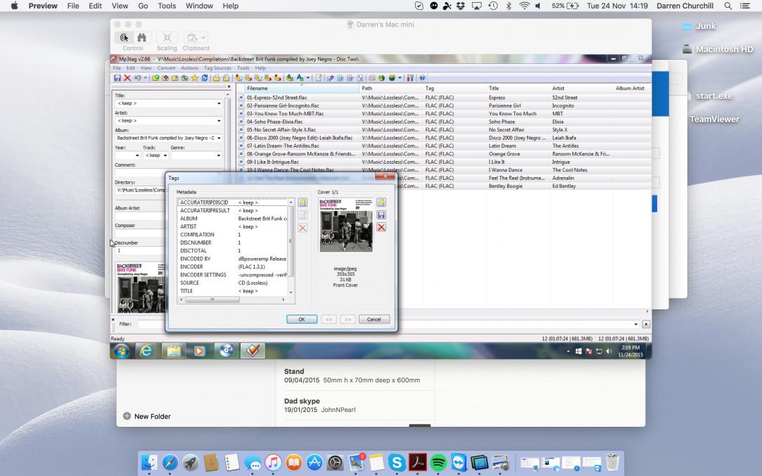

                              Re: Artist Tag?
Name:	Screen Shot 2015-11-24 at 14.19.48.jpg
                              Yes seems that compilation tag are populated with a value =1
