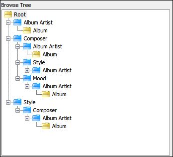

    Here's what my browse tree looks like in Asset....
    It's got me stumped....can any help me please?
