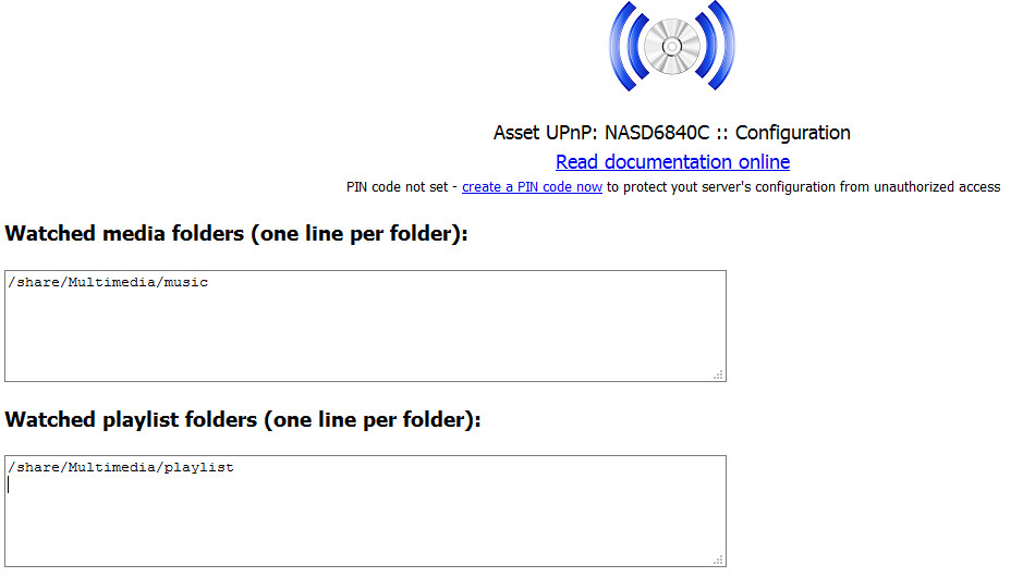

            ... also, in Asset UPnP Configuration >> Advanced Settings
            what do have listed in the Audio Library section?

              Do you mean the menu in the attached picture?

                is not valid because it is relative to the application which created it, Asset runs from a different location, you would need the full music path starting /share/Mu...
                  Re: Asset playlist and NAIM App
                  In MP3Tag >> Options >> Playlist, un-tick the Entries relative to work directory option.
                  Try creating the playlist again and check if the full path is written to the playlist.
                  ... if the Asset Library folders are local, this is working well. I just have not tested this for a network share, when the full path is either a UNC path or Mapped Drive path.
