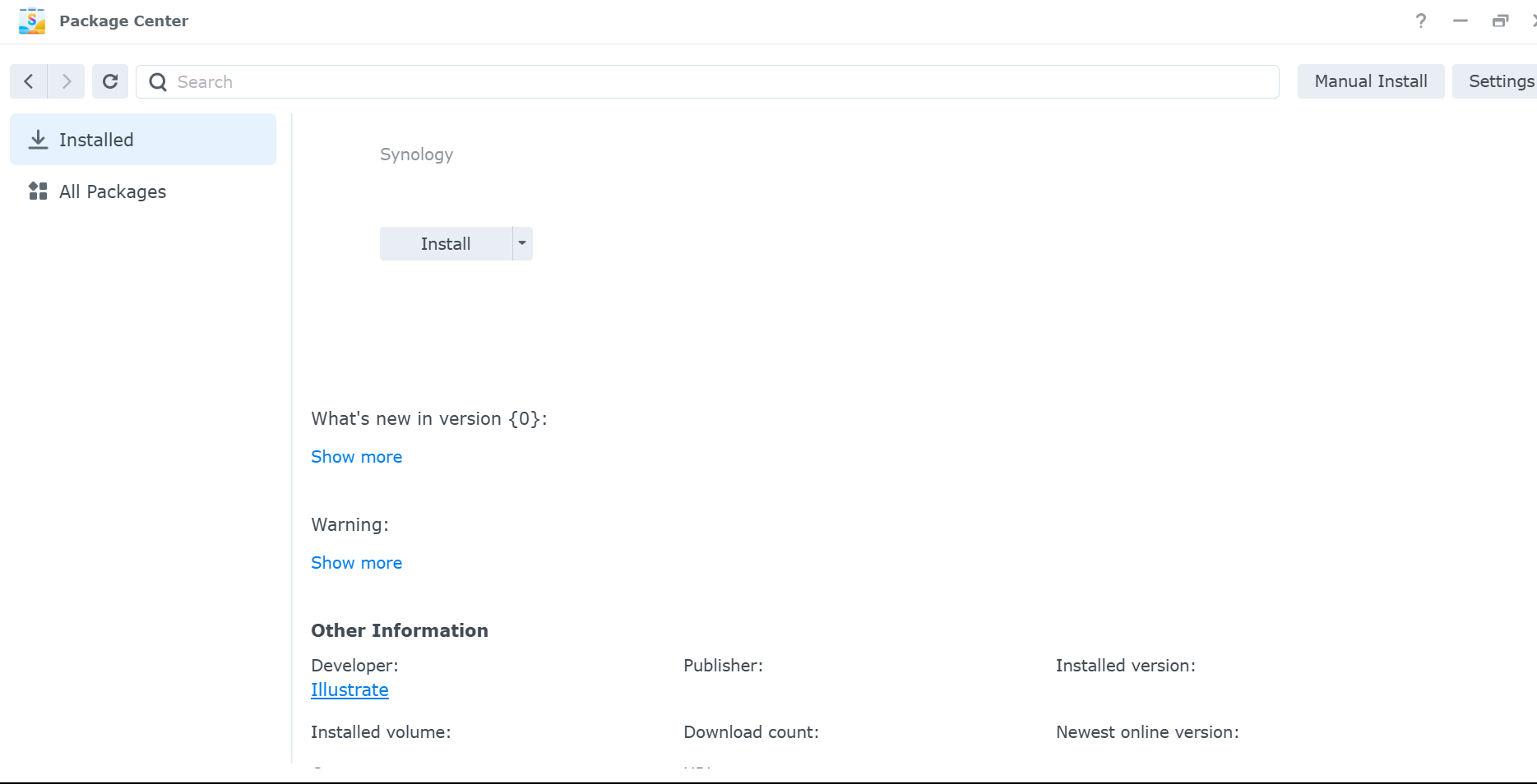

    I've installed R2024-12-16 on Synology DSM7 and its not showing correctly in Synology Package Center in the Installed subsection
    The Asset logo is missing as are the various links
    Its showing as waiting to Install but it is installed and it is showing and playing correctly on the iPad - Naim app

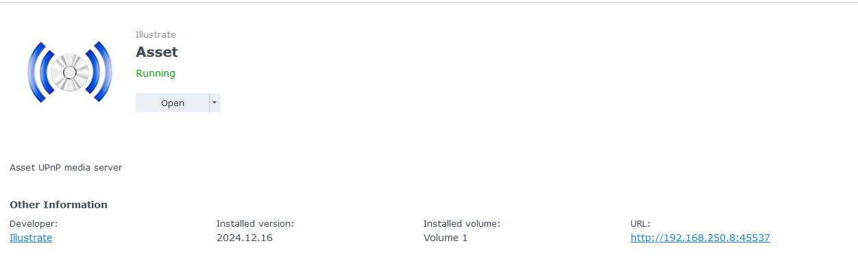

      After I first manually installed the new Asset version on my DS1821+ the screen still showed the beta version date that was there when I started the install. A minute or so later the screen updated as expected.
      I suggest that you try again to do a manual install of the new version because it worked for me.I'm also on the latest DSM build for the NAS so if you're not, you might try that too before manually updating.

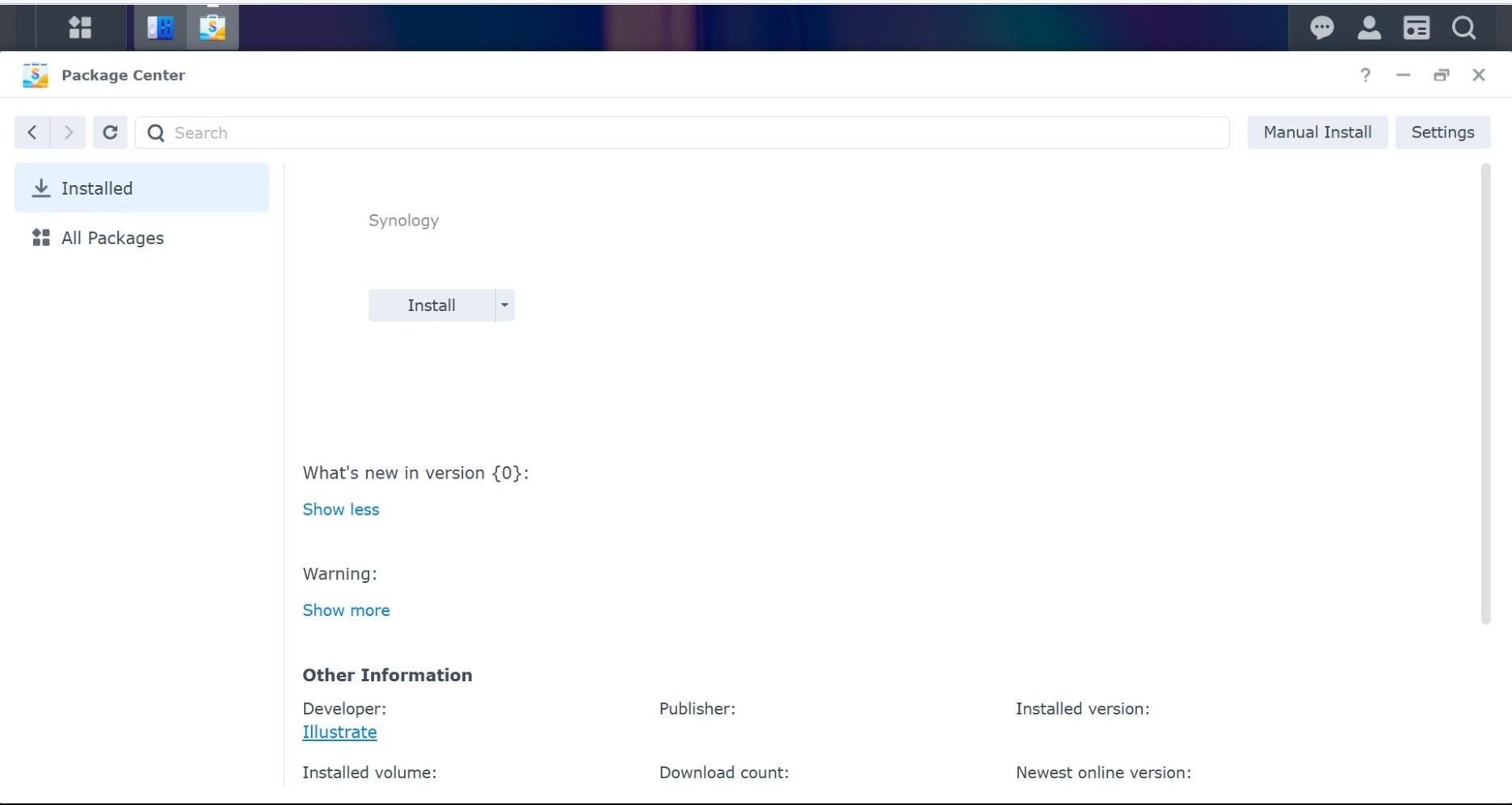

        No change, still not displaying GUI correctly, no Asset logo & no links - see att screenshot
        It still shows and plays OK on iOS Naim app, but all settings have reverted to default.
        Click image for larger version  Name:	{F8E7689A-5725-40C0-A61C-029E034AEA34}.png Views:	0 Size:	66.3 KB ID:	329605

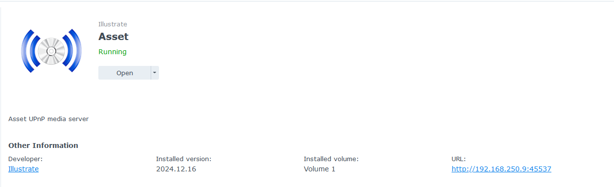

              In case it helps, I just did a clean install of Asset UPnP on my DS 220J backup nas running DSM 7.2.2 - 72806 Update 2 and no issues.

                      I'll just installed the latest Asset 2025-02-03 in an attempt to fix this problem.
                      Sorry but no change, the Synology GUI is still incomplete (see attachment photo) Asset logo and the various linksinoperative and information missing
                      I've tried uninstalling it Synology but none of the Synology commands work
