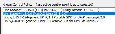

              • MSchenk
                • Jul 2014
                • 24
                Please open Asset Configuration, General Settings / Settings Override (Control Point Specific) / Edit Override Values
                Under right pane (known control points), what does it list?​

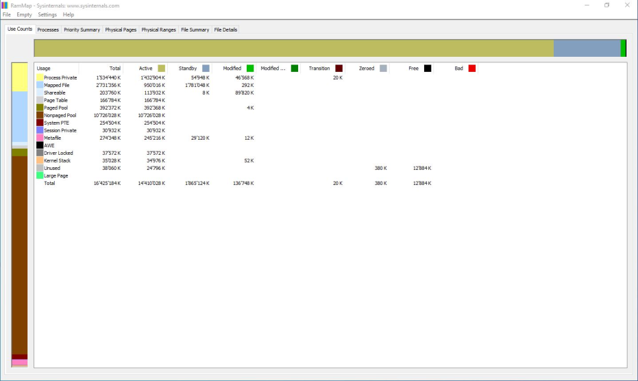

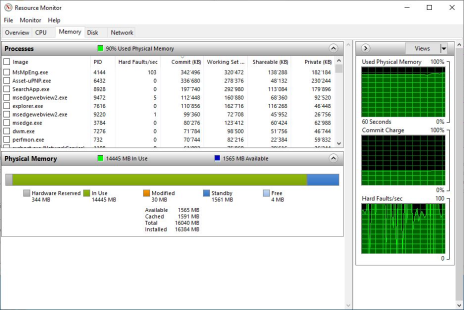

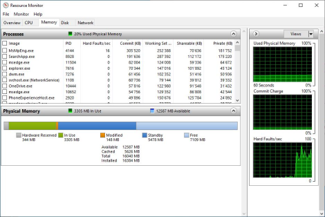

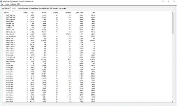

                    As requested re-tested with version 2024-09-23. I've used Resource Monitor and in addition RamMap
                    Start
ID:	328546Click image for larger version
                    • MSchenk
                      • Jul 2014
                      • 24
                      After 7 hours near all of the memory is used

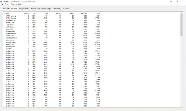

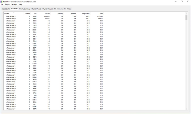

                      There are hundreds of uMediaLibrary- processes visible in RamMap

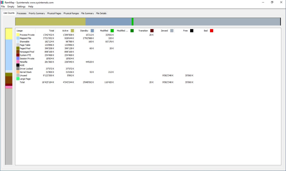

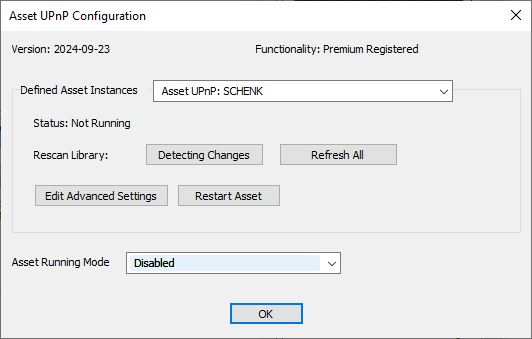

                        After 7 hours and a few minutes I disabling Asset UPnP
                        Click image for larger version  Name:	image.png Views:	0 Size:	82.8 KB ID:	328554
                        Click image for larger version  Name:	image.png Views:	0 Size:	118.3 KB ID:	328555
                        Click image for larger version  Name:	image.png Views:	0 Size:	116.3 KB ID:	328556
                        Click image for larger version  Name:	image.png Views:	0 Size:	123.4 KB ID:	328557
                        Conclusion:
                        After disabling Asset all memory was released so this is, at least for me, a clear indication that Asset is responsible for consuming the memory.
                        After disabling Asset all those hundreds of uMediaLibrary- processes​ are gone

                          • 46231
                          That is the issue, there should be one uMediaLibrary process for each asset configuration, we will investigate why there are multiple

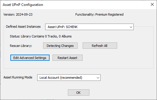

                              Hi I've try to install the hotfix after update to 2024-09-23 but now I get the following (0 Tracks, 0 Albums)
