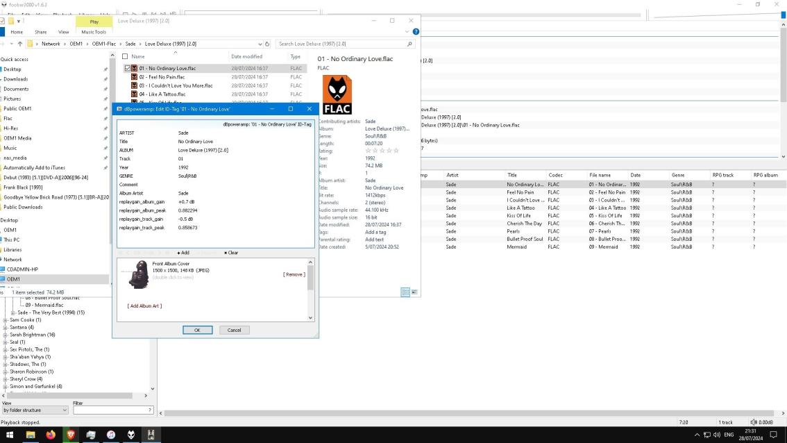

    Has anyone noticed that RPG settings applied by DBPoweramp to FLAC files, do not always appear in Foobar2K detaiis for that file.
    cheers for any thoughts, CD

    i have never seen this issue and I have about 130,000 FLAC files created with dbpoweramp. Foobar2000 always shows replaygain tag info.

      What am I doing wrong?
        • 6188
        That looks like windows explorer not showing RG tags. I don’t see a foobar2000 window.

          foobar is the max'd window at the back, with the "?"'s
            • 6188

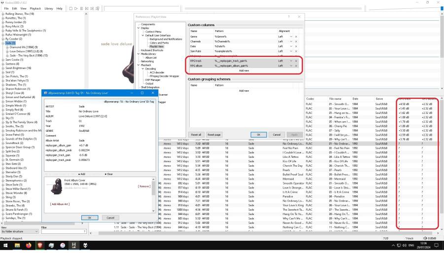

            Ok. See it now. I suspect you’ve put an incorrect value in your column definitions. I’m not home to see what definition I’ve used.
              • 6188
              try these definitions
              %__replaygain_album_gain%
                  %__replaygain_track_gain%
                  looks like there's something going wrong with the columns formatting, I changed the Foobar columns to those you suggested and all values of existing files immediately become a "?".
                  Restarted Foobar, and all values returned except for those that didn't show earlier on. weird!
                  I was using %REPLAYGAIN_ALBUM_GAIN% and %REPLAYGAIN_TRACK_GAIN% didn't think that the CASE was important...
                  cheers CD

                        I was just guessing on column naming as I’m away from home and can’t test.
                              No probs, the RPG settings still don't show on some files in Foobar.. that's how things are I guess.
